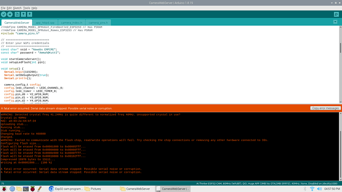

I have a ESP32-s cam board and i tried to upload the examples \> esp32 \> camera \> cameraWebServer program in arduino but i got this below error. can some one help me out please.
Sketch uses 1510681 bytes (48%) of program storage space. Maximum is 3145728 bytes.
Global variables use 70388 bytes (21%) of dynamic memory, leaving 257292 bytes for local variables. Maximum is 327680 bytes.
[esptool.py](http://esptool.py/) v4.5.1
Serial port /dev/ttyUSB0
Connecting....
Chip is ESP32-D0WD (revision v1.0)
Features: WiFi, BT, Dual Core, 240MHz, VRef calibration in efuse, Coding Scheme None
WARNING: Detected crystal freq 41.36MHz is quite different to normalized freq 40MHz. Unsupported crystal in use?
Crystal is 40MHz
MAC: a8:03:2a:64:bf:34
Uploading stub...
Running stub...
Stub running...
Changing baud rate to 460800
Changed.
WARNING: Failed to communicate with the flash chip, read/write operations will fail. Try checking the chip connections or removing any other hardware connected to IOs.
Configuring flash size...
Flash will be erased from 0x00001000 to 0x00005fff...
Flash will be erased from 0x00008000 to 0x00008fff...
Flash will be erased from 0x0000e000 to 0x0000ffff...
Flash will be erased from 0x00010000 to 0x00182fff...
Compressed 18992 bytes to 13110...
Writing at 0x00001000... (100 %)
A fatal error occurred: Serial data stream stopped: Possible serial noise or corruption.

same error again -
 ![20240126_16h57m51s_grim](https://europe1.discourse-cdn.com/arduino/original/4X/c/d/4/cd4729c2e3c4bd6bccbf464afc60b261a2f5077e.png)

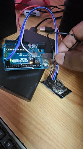

I tried to change the brown wire to other GND but same issue. I don't have other ftdi module.
I have a Arduino Uno how to upload code to esp32 cam via Uno. I'll try.

Tried using Arduino Uno. Connection and errors below
 ![20240126_194827](https://europe1.discourse-cdn.com/arduino/original/4X/6/3/b/63b6a83c417bbe8eba6062cfe07dd885aa8e91d3.jpeg)
 ![IMG-20240126-WA0004](https://europe1.discourse-cdn.com/arduino/original/4X/6/b/f/6bfcadea2a1e8bcd3cbad567d20a21814af9f757.jpeg)

When you are using an Uno board as a USB to serial adapter, confusingly the connections are like so:
| Uno | Target |
| RX | RX (e.g., U0R) |
| TX | TX (e.g., U0T) |
The reason for this is that the pin labels on the Uno are referring to the pins on the ATmega328P microcontroller, but in this usage you are communicating directly between the Uno's USB to serial chip (ATmega16U2) and the target. Since the connections between the USB chip and the ATmega328P are RX-TX, TX-RX, the pin marked "RX" on the Uno is actually connected to the TX pin on the USB chip and the pin marked "TX" on the Uno is actually connected to the RX pin on the USB chip.
With the Uno, you have the problem of exposing the ESP32's U0R pin to 5 V as I suspected was also occurring with your FTDI module. It is possible this has caused permanent physical damage to the ESP32 and that physical damage might be the reason the upload is failing.
When you are using an Uno as a USB to serial adapter, it is best to connect the "RESET" pin on the Uno to the "GND" pin in order to hold the ATmega328P microcontroller in reset. Otherwise the ATmega328P might interfere with the communication between the Uno's USB chip and the target.

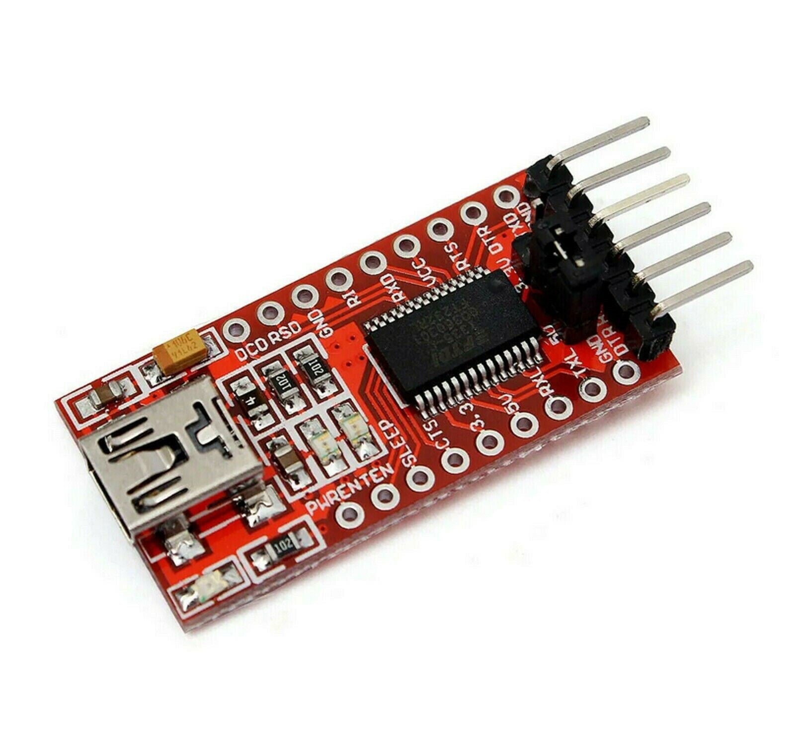

It is easy and streightforward to use a TTL interface to prgram the ESP32cam like this:
> **[FTDI FT232RL USB to TTL Serial Converter Adapter Module 5V/3.3V](https://phillipjfry.com/products/ftdi-ft232rl-usb-to-ttl-serial-converter-adapter-module-5v-3-3v?_pos=1&_psq=TTL&_ss=e&_v=1.0)**
> FTDI FT232RL USB to TTL Serial Converter Adapter Module 5V / 3.3VFeatures:Material: PCB, Electronic ComponentThe USB power supply can choose 5V or 3.3V, set by jumper.Draw out all signal port of FT232RL chip.RXD / TXD transceiver communication...
I also built a breakout SMB for both ESP32cam and ESP8266
 ![avecTTL](https://europe1.discourse-cdn.com/arduino/original/4X/b/9/c/b9ccd700a87f2fe6181399d398064f1a3c518570.jpeg)
which works very good.
I may sell you that. If you want. I have not price yet, never sold. You can have it as DIY kit or all done.
