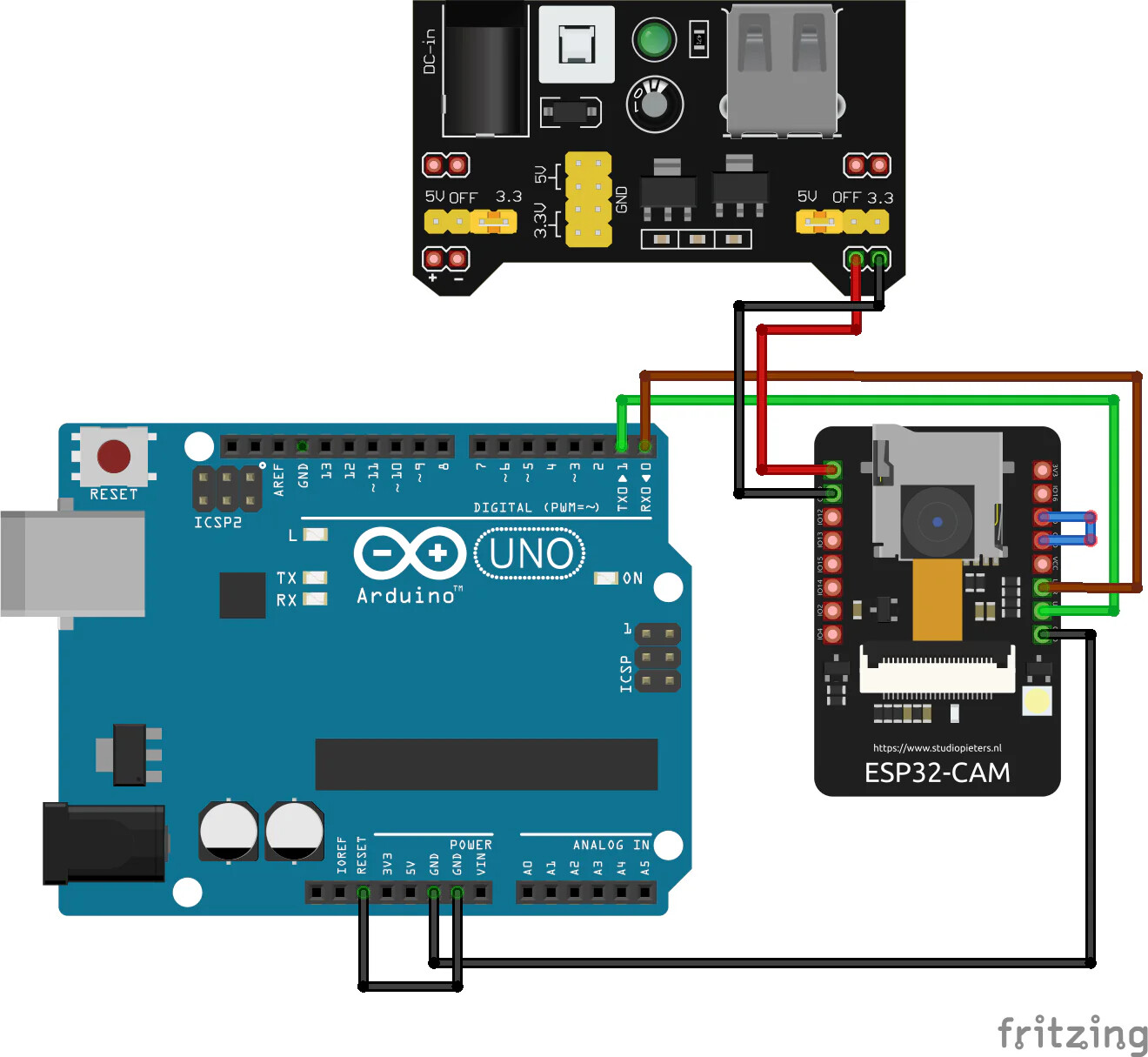

I've uploaded the code to the cameras using another ESP32 and an Arduino Uno via UART communication. I recently purchased the ESP32-CAM-MB, and every method I've tried hasn't worked. I've tried powering the board directly with 5V from the Arduino connected to a 9V battery, connecting it directly to a power source with a 5V regulated cell phone cable, connecting it directly to the computer, and using a 9V battery with a STEP DOWN for a 5V output.

You need a better power supply, as the ESP32-CAM can draw 10X more current than an Arduino. 9V batteries will barely power an Arduino Uno, and even then only for a few minutes.

You can NOT power an esp32cam with a 9V battery. I have tested a lot of the MB boards and a lot are defective. Use a FTDI board and plug the 5V pins and use a wall wart (I think you said you have one)

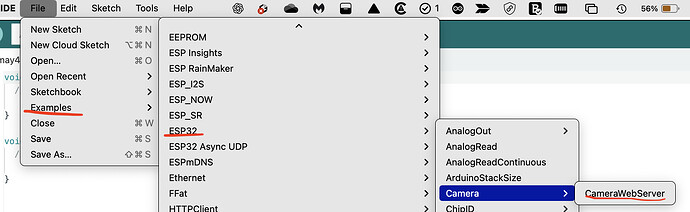

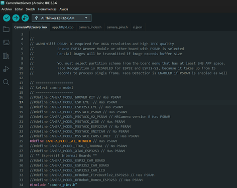

Now the important part, get the esp32cam sample code and edit it to select the correct camera. Most esp32cam errors are due to not selecting the correct camera or a poorly inserted camera cable.

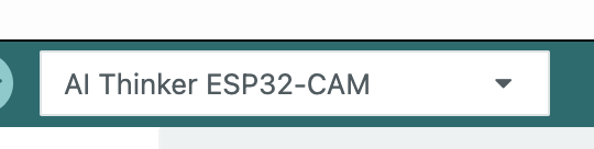

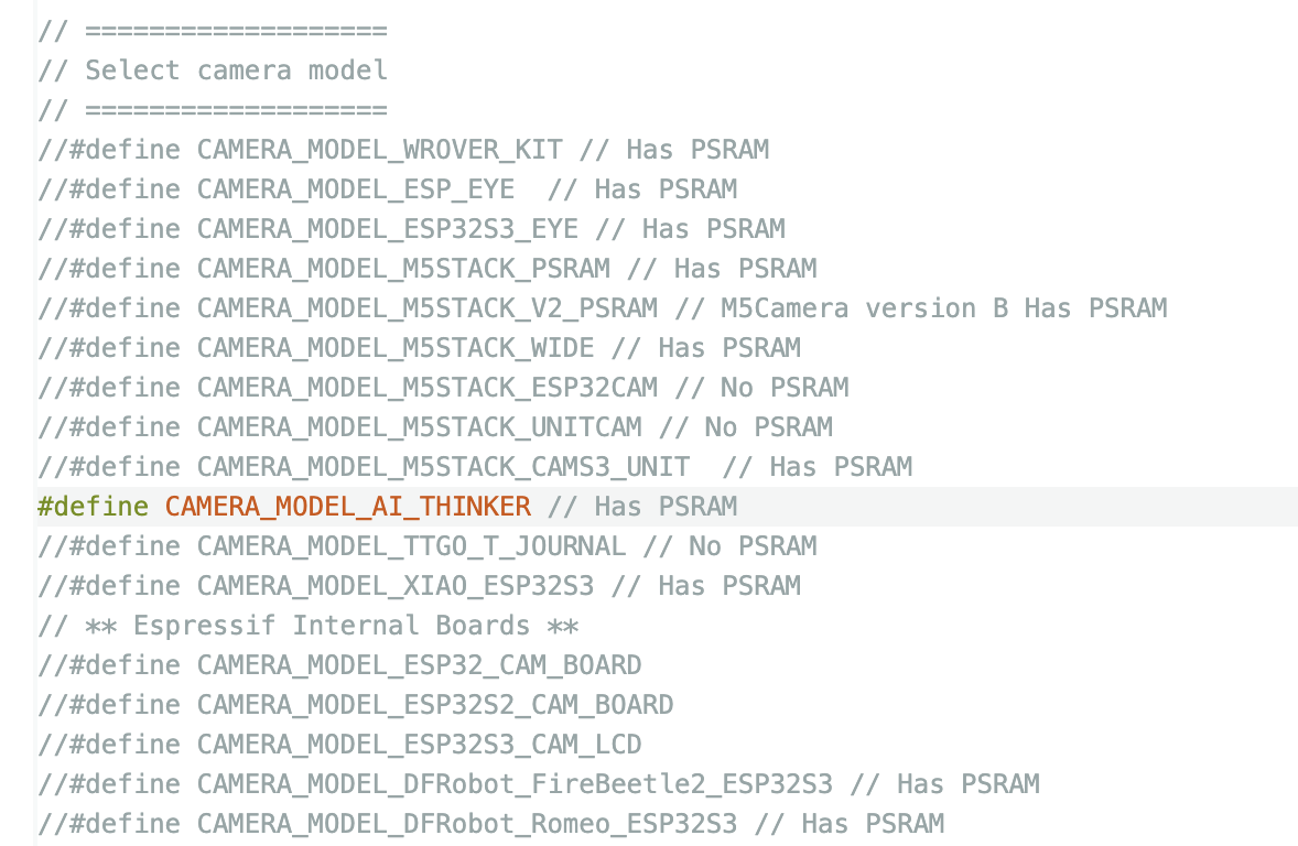

Here is the location of the standard sample sketch and I am including the board to select. I have done screen grabs for the camera selection showing the example and what you need to change for the AI_THINKER that I think you have.

To power it with the 9V battery I used a breadboard power supply board (mb102) and configured it to 5V and used a 30 and 38 pin ESP32 to upload the code and the same with an Arduino Uno (Connections as in the photo)

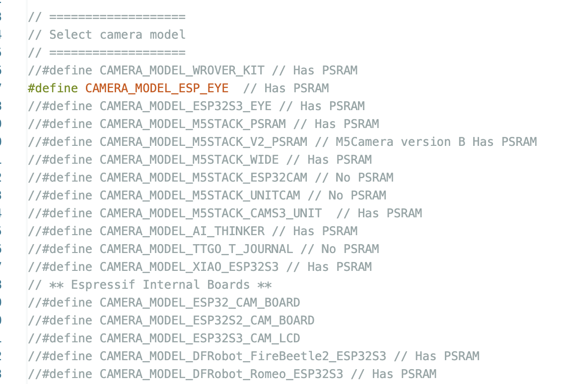

I uploaded the sample code with the modifications you mentioned and I got this error on the serial monitor.
E (496) esp_core_dump_flash: No core dump partition found!
E (467) camera: Camera probe failed with error 0x105(ESP_ERR_NOT_FOUND)
Camera init failed with error 0x105

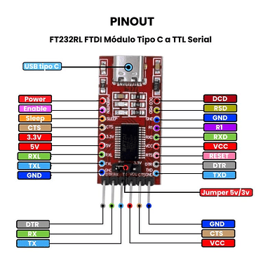

Tomorrow I'm going to buy the FTDI module you mentioned so I can try it out. I'll add a photo of the one they sell locally to see if it works for me.

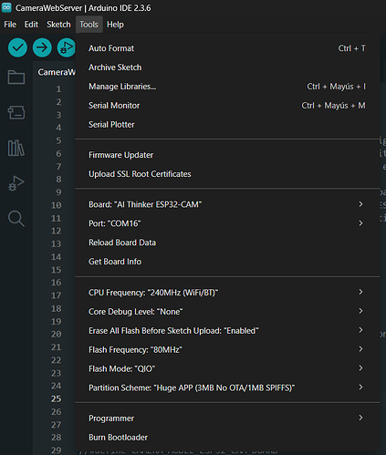

That 105 error typically means you did not define the correct camera, do you understand that? Maybe do a screen grab to show me.
You can NOT use a 9V battery with a board that has radios.
That is a wild FTDI module, I have never seen all those pins, you just need the 5V jumper, USB, and the 4 pins, TX, RX, VCC, G

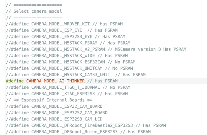

@sonofcy I'm sending you a photo of how I have the IDE configuration and the example code.
