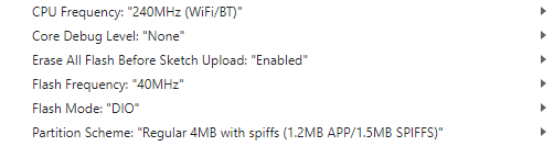

ESP32-Cam resets after connecting to WiFi
first of all Im a newbie so sorry if the problem im encountering is just an easy fix.
I want to send an stream of images to a PC using ESP32-Cam for an image processing application. I need to do this using UDP.
now I have made a code using ChatGPT and tweaked it a little bit, but the problem is that every time the ESP32 connects to the WIFI, it automatically resets.
I powered it with a suitable power source and a 650uF capacitor to prevent power shortage.
I also turned off the watch dog and the brownout detection in the code just in case, but couldn't fix the problem.
here is my code right now:

and heres the error I get in the serial monitor after running it:
Rebooting...
ets Jul 29 2019 12:21:46
rst:0xc (SW_CPU_RESET),boot:0x13 (SPI_FAST_FLASH_BOOT)
configsip: 0, SPIWP:0xee
clk_drv:0x00,q_drv:0x00,d_drv:0x00,cs0_drv:0x00,hd_drv:0x00,wp_drv:0x00
mode:DIO, clock div:1
load:0x3fff0030,len:4604
ho 0 tail 12 room 4
load:0x40078000,len:15488
load:0x40080400,len:4
load:0x40080404,len:3180
entry 0x400805b8
assert failed: esp_sleep_pd_config sleep_modes.c:1974 (refs >= 0)
Backtrace: 0x400829e1:0x3ffb2020 0x4008dbf1:0x3ffb2040 0x400937a6:0x3ffb2060 0x400e0992:0x3ffb2190 0x400d2864:0x3ffb21b0 0x400d7e6b:0x3ffb2270 0x400902aa:0x3ffb2290
ELF file SHA256: 2689e83fb761db6d
this just keeps getting spammed in my monitor
I suggest you use one of the example camera programs for the ESP32-Cam.
I think chat gave you the wrong GPIO numbers.
I used the camera_pin.h file in the examples to set the camera pins in this code.
with the AI Thinker camera, which worked fine in the other examples with HTTP
Does the 'CameraWebServer' example provided in the Arduino IDE work OK ?
That is not what your error messages show. Does not look like it ever connected.
I would remove the Wifi. setSleep and esp_sleep_pd_config and see if it works.
yes this is actually after some tweaking i did, if i remove the lines you said, the Wifi will connect, creap an IP and reset again, this is my serial monitor (keeps sending this):
rst:0x8 (TG1WDT_SYS_RESET),boot:0x13 (SPI_FAST_FLASH_BOOT)
ho 0 tail 12 room 4
entry 0x400805b8
Free heap before Wi-Fi: 294452
Connecting to Wi-Fi........
Connected!
192.168.100.110
Free heap after Wi-Fi: 241484
Free heap before camera init: 241484
I don't have the ESP-cam but I ran your code on an ESP32 devkit and it got as far as printing "UDP initialized" then gave an error. Not sure but it probably has something to do with sending the UDP packets.
I found this project on Github and used its code which is fairly different from the one generated by ChatGPT, it had some errors while compiling because of a change in the ESP32 library, and also the camera pin config wasnt correct,

I could receive the frames on the PC, but still cant reconstruct the images good enough. and the FPS is very low about 3 to 5 FPS with VGA quality.
any suggestions for improving it on the ESP32 side? (my coworker does the receiver side with Python OpenCV cuz I don't know anything about that side)
Out of my area of expertise
I fixed the issue.
apparently the ESP32 ran out of memory or something similar (I'm just guessing). I fixed it by using a different partition scheme (in tools drop down menu) while uploading the code.
