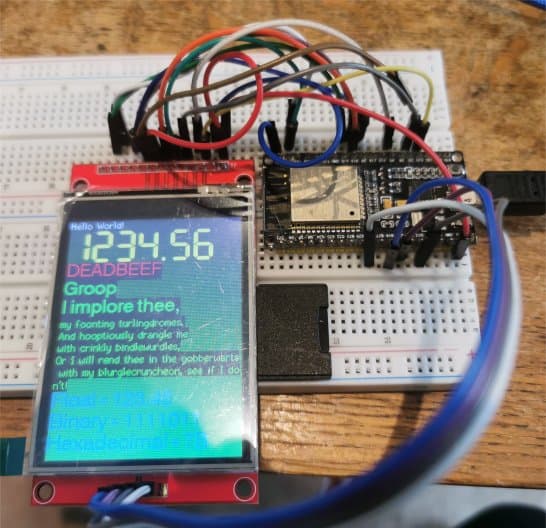

I use a ESP32 DEV module. I must connect 2 x SPI devices to the unit.
4 Inch Display with Touch SPI (don't use the TOUCH)
and a SD card reader.
the LCD CS is connected to GPIO 5
and the SD card CS is connected to GPIO 15.
if I test each devise on its own it works but when I combine the 2 devices the SD card
do not work.
the LCD uses Adafruit_GFX and TFT_eSPI libraries
the Sd card reader uses the standard SD library

if the SD card is sharing a SPI bus with other devices there can be problems - see Sharing the SPI bus among SD card and other SPI devices
try connecting the TFT to VSPI and the SD card to HSPI
can you give a link to the TFT?
EDIT: have a look at post 2-4-tft-lcd-with-sc-card-barometer-on-a-uno
some more tests using ILI9341 color TFT touch display using VSPI and SD card using HSPI

// SD card test ILI9341 color TFT touch display using VSPI and SD card using HSPI
// see https://forum.arduino.cc/t/esp32-initialize-hspi-as-default-spi/1155093/12

both TFT test (refreshes screen every five seconds) and SD card test (reads SD on a keypress) work OK
serial monitor displays
ESP32 TFT_eSPI library  example TFT_Print_Test with SD card reader
TFT setup
SD setup
Setting up SD card
SD Card Type: SDHC
SD Card Size: 15193MB
Listing directory: /
  DIR : System Volume Information
  FILE: test.txt  SIZE: 1048576
  FILE: foo.txt  SIZE: 13
  DIR : FOUND.000
  DIR : Blink_LED
  FILE: information.txt  SIZE: 11527
  DIR : FOUND.001
Creating Dir: /mydir
Dir created
  DIR : FOUND.000
  DIR : mydir
  DIR : Blink_LED
  DIR : FOUND.001
Removing Dir: /mydir
Dir removed
Listing directory: System Volume Information
Failed to open directory
  DIR : FOUND.000
Listing directory: FOUND.000
  DIR : Blink_LED
Listing directory: Blink_LED
  DIR : FOUND.001
Listing directory: FOUND.001
Writing file: /hello.txt
File written
Appending to file: /hello.txt
Message appended
Reading file: /hello.txt
Read from file: Hello World!
Deleting file: /foo.txt
File deleted
Renaming file /hello.txt to /foo.txt
File renamed
Reading file: /foo.txt
1048576 bytes read for 2373 ms
1048576 bytes written for 2500 ms
Total space: 15173MB
Used space: 3MB
TFT redraw screen
TFT redraw screen
photo of setup
Note: connect VCC to 5V if J1 open else 3.3V
