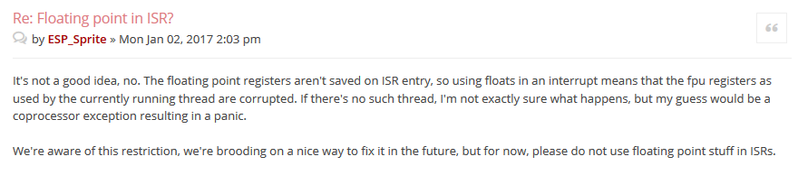

You should not use floating point in an ISR.

I have read this info. Since it is more than 2 years old, I have not payed any attention to it. I thought It is already solved. But I will try to play with type of Lambda, if anything changes. One can never be sure. Thanks.
What is the best before date of rules or information?
Why should somebody fix a thing that is not broken?
You don't want the overhead of saving/restoring all floating point registers for each ISR.
You are not supposed to use floating point in an ISR,
if you have to, you have to save and restore the floating point hardware state yourself,
or you will screw up the normal code floating point system.

This is solution of the problem. I changed type of the Lambda variable from float to long. Since then I am not getting any error messages from the ISR.
