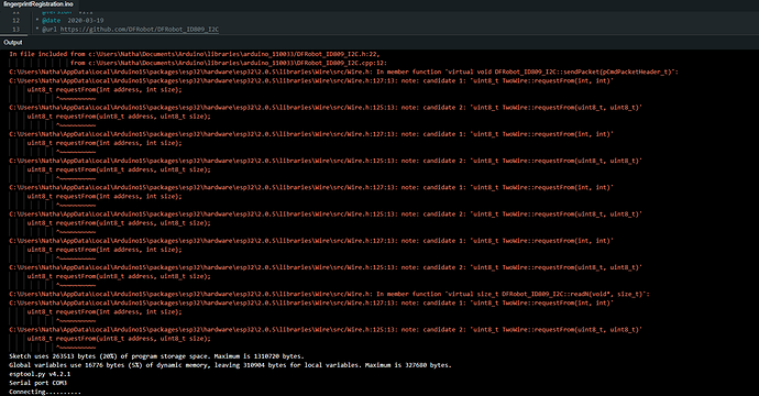

I've been stuck for hours trying to figure out how to get my finger print sensor to work. I'm using a ESP32NodeMCU, programmed through the ArduinoIDE. I'm simply trying to run the example code that comes along with it but nothing is being output on the serial monitor. I have a suspicion that the issue resides with the Wire.h library/ I2C bus. I've added 2k, 4.6k, 10k pull ups the SDA/ SCL as required for the ESP32 (only reasonable resistor sizes I had) but neither option has changed the result. I've checked the wiring numerous times and I've even tried the code on a back up sensor I brought just in case. I just have no idea why it isn't working. I'll included a weird error message I get along with the example code they provide. I'll also link the github page: GitHub - DFRobot/DFRobot_ID809_I2C.
One thing about the error message is the code compiles and still uploads but clearly something isn't right.
Error message:

I get this error message:
In file included from c:\Users\Natha\Documents\Arduino\libraries\arduino_110033/DFRobot_ID809_I2C.h:22,
                 from c:\Users\Natha\Documents\Arduino\libraries\arduino_110033\DFRobot_ID809_I2C.cpp:12:
C:\Users\Natha\AppData\Local\Arduino15\packages\esp32\hardware\esp32\2.0.5\libraries\Wire\src/Wire.h: In member function 'virtual void DFRobot_ID809_I2C::sendPacket(pCmdPacketHeader_t)':
C:\Users\Natha\AppData\Local\Arduino15\packages\esp32\hardware\esp32\2.0.5\libraries\Wire\src/Wire.h:127:13: note: candidate 1: 'uint8_t TwoWire::requestFrom(int, int)'
     uint8_t requestFrom(int address, int size);
C:\Users\Natha\AppData\Local\Arduino15\packages\esp32\hardware\esp32\2.0.5\libraries\Wire\src/Wire.h:125:13: note: candidate 2: 'uint8_t TwoWire::requestFrom(uint8_t, uint8_t)'
     uint8_t requestFrom(uint8_t address, uint8_t size);
C:\Users\Natha\AppData\Local\Arduino15\packages\esp32\hardware\esp32\2.0.5\libraries\Wire\src/Wire.h: In member function 'virtual size_t DFRobot_ID809_I2C::readN(void*, size_t)':
I'm not running this in a simulation, I've created the circuit on a breadboard and I've also used the I2C scanner to verify it has found the fingerprint scanner at the correct address:
Scanning...
I2C device found at address 0x1F  !
done
This is the circuit on the breadboard:
I've checked that the SDA/ SCL are indeed on pin 21 and 22 respectively. I'm a bit confused as to whether I've connected the pull up resistors correctly but I think they are in the correct place as shown in the image.
My issue is that the module information is not being printed on the serial monitor. It remains blank. I should be seeing some basic information about the fingerprint sensor as shown by the example on their webpage: Gravity: Capacitive Fingerprint Scanner/Sensor Arduino Wiki - DFRobot
Here's their github again which contains the library and code examples: GitHub - DFRobot/DFRobot_ID809_I2C

Are you trying to the exact same thing as me? Using the DFRobot :Gravity capacitive fingerprint sensor with an ESP32 of some sort? If so then no, after various trouble shooting I could not find a way to get the sensor to work. This error I talked about here was a warning message and actually didn't interfere with running the code. However after fixing it the code would not go past the:
fingerprint.begin(); Method
for an unknown reason. There is a shining light though, I decided to test the sensor with an ESP8266 and it managed to run the fingerprint matching example and device information example perfectly, so if you have one around or can order one of those try it with the ESP8266 instead.
To fix the warning message:
  1. Go into the .cpp file that is where ever you installed the DFRobot_ID809_I2C library on your computer. mine was in c:\Users\insert_username_here\Documents\Arduino\libraries\arduino_110033\DFRobot_ID809_I2C.cpp
  2. Change all _pWire->requestFrom(_deviceAddr, 1); occurrences to:
_pWire->requestFrom(_deviceAddr, (uint8_t)1);
There should be 5 in total, that'll get rid of the long warning message that pops up.
