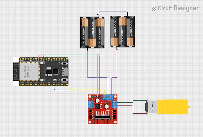

I’m using an ESP32 and L298N to control a DC motor, and I’ve set up a web interface to adjust the motor speed. Here's my hardware setup:
  • ESP32
  • L298N
  • Power: 6 AA batteries in series
  • Motor connected to the L298N
Problem:
When I connect the ENA pin of the L298N to GPIO 19 on the ESP32 for PWM speed control, the motor doesn’t run at all. However:
  1. If I remove the ENA connection and use the jumper cap to short ENA on the L298N, the motor runs fine (but speed cannot be controlled).
  2. If I connect ENA directly to the ESP32’s 5V power output, the motor runs (but speed still cannot be controlled).
Questions:
  1. Is this a hardware wiring issue or is there a limitation with the L298N’s ENA pin?
  2. Is my PWM setup correct in the code?
  3. Is there a better way to control the motor speed using the ESP32 and L298N?
Here’s my schematics:
Note: Battery are all AA Battery

You need to post the description of the hardware and its name is "Schematics".
done just uploaded it!
just uploaded it
Please add new information in a new reply. Else the following replies look odd.
You tried, but... That's not a schematic.
Sorry but that picture is useless to me. You can make Your grandmother wire it without understanding anything. Helpers need to understand.
Helpers that don't play daily with exactly those circuits have no help of pin positions.
Sorry, I'm out.
