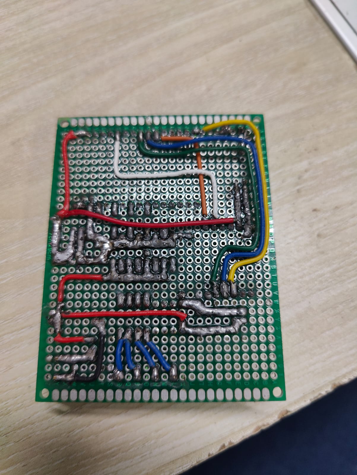

I’m working on a project using an ESP32 to control a 12V contactor, with a W5500 Ethernet module for internet connectivity. The issue I’m encountering is that the ESP32 either restarts or loses its network connection whenever the contactor is switched on or off.
Project Setup:
  • ESP32 controlling a 12V contactor via a transistor-based driver circuit using the ULN2003A IC.
  • W5500 Ethernet module for network communication.
  • Powering the ESP32 and W5500 from a 5V buck converter that steps down from a 12V SMPS, which also powers the 12V contactor.
  • The ULN2003A has built-in flyback diodes for inductive load protection.
  • I’ve added 2 x 470µF capacitors and 2 x 100nF capacitors to stabilize the power supply for the ULN2003A.
The Problem:
Whenever the 12V contactor switches (on or off), the ESP32 restarts or loses its network connection. I suspect this is due to either EMI from the contactor or voltage transients affecting the power supply shared with the ESP32.

First of all: pretty neat setup. But the back of your print worries me...
How can you be sure that the tracks on the back do not have unwanted connections?

You should keep wires to and from relay together as a bundle. That will reduce EMI. Same for the power supply lines.

I’ve checked my connections multiple times to ensure there are no shorts, and I also performed continuity tests without finding any issues. The setup works as intended most of the time, but I experience occasional restarts or disconnections of the ESP32 when the contactor switches.
