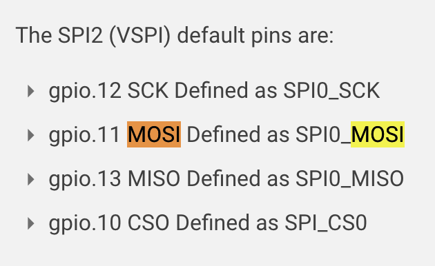

I just noticed you said you don't have a pin 23 for MOSI. The pin number can be anything, but the pin purpose in this case MUST be MOSI. There will either be a label on the board top or bottom, or in the datasheet for the board, OR it ca be software specified.
Thank you Sonofcy for wanting to help me with this, admittedly, I'm quite a novice at this and trying to figure this all out.
Yes, I did read that the MOSI pin can be defined as anything, and in my case I set it as 11. The ESP32-S3-Dev pin reference under SPI, also mentions MOSI pin is 11.
Do you think that is the issue why the text does persist after it's been updated?
I agree 11 is right, I don't think it can be any other pin, similarly for all the other SPI pins for SPI2. SPI3 can be any pin.

You can find the default HW SPI pins used then e.g. in
arduino-esp32/variants/esp32s3/pins_arduino.h at master · espressif/arduino-esp32 · GitHub
static const uint8_t SS = 10;
static const uint8_t MOSI = 11;
static const uint8_t MISO = 13;
static const uint8_t SCK = 12;
If you need to use different pins, then you need to re-map the HW SPI pins.
