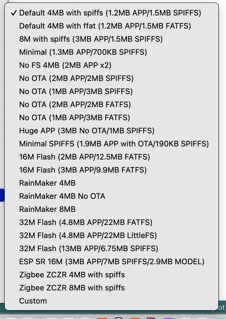

I just had a new board made with an ESP32-S3. I've tried everything practical but I keep getting
Leaving...
Hard resetting with RTC WDT...
and serial monitor is spazzing out with "no bootable app partition"
I'm completely lost at this point.
mode:DIO, clock div:1
load:0x3fce2820,len:0x118c
load:0x403c8700,len:0x4
load:0x403c8704,len:0xc20
load:0x403cb700,len:0x30e0
entry 0x403c88b8
E (26) boot: No bootable app partitions in the partition table
What does your partition table look like. The default is usually ok.
