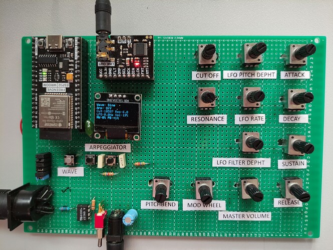

This post provides an overview of a synthesizer project based on the ESP32-S3 microcontroller. A notable aspect of its development was the use of Google Studio AI for generating a significant portion of the code.
Key Synthesizer Features:
The current iteration of the synthesizer includes the following core features:
  • Played via MIDI input with 5pin DIN Midi Connector (standard MIDI messages).
  • Audio Output: Sound is output through an external PCM5102 I2S DAC for improved audio quality.
  • Display: An OLED (0,96) screen shows key parameters like active waveform, envelope settings, arpeggiator status, etc
  • Waveform Generation: Supports basic waveforms (e.g., square, sawtooth, sine). Specifics will be detailed with the code.
  • Monophonic Operation: The synthesizer is currently monophonic, producing one note at a time.
  • Envelope Control: Includes basic envelope parameters (e.g., Attack, Decay) to shape the sound.
  • Pitch Control: Standard control over the fundamental frequency of the generated sound.
  • Arpeggiator: Features a built-in arpeggiator. When multiple notes are held via MIDI, the arpeggiator cycles through them sequentially based on selected patterns (e.g., Up, Down, Up/Down, Random) and speed.
  • VCF Basic Filter: A simple low-pass filter is implemented.

Project Files & Resources:
The complete source code, any schematics, and sound examples for this project are hosted on GitHub. You can find everything here: esp32_audio
