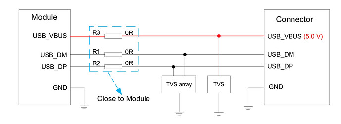

Greetings!
i have the esp32-s3-wroom-1 module installed on my pcb and its powered fine via 3.3v and all. The pins 19 and 20 are connected to the d- and d+ of usb plug for communication but here is the problem, when i plug it in my pc it does connect but after about 5 seconds it disconnects and then makes the disconnecting sound every 3 seconds without the reconnecting sound in between. the lines go straight from usb to pads except they go trough a 0 ohm jumper resistor and are connected to a tvs array. when i use multimeter to mesure the voltage on the digital lines, each time it disconnects, voltage drops to around 1.5-2v then comes right back up just like a spike of some sort. My only unexplored route is the gpio3 which is used to set the jtag, it is used to connect to something else but is left floating at startup. the voltage on the digital lines is also at 3v ( aint it supposed to be at 5v?)

I have no clue what you ar doing. You will need to post Tools/Auto Format code in ^^^ CODE tags, also if there is any output messages. Then a hand drawn diagram of the hardware, and of course a description about what you expect, and what is actually happening.

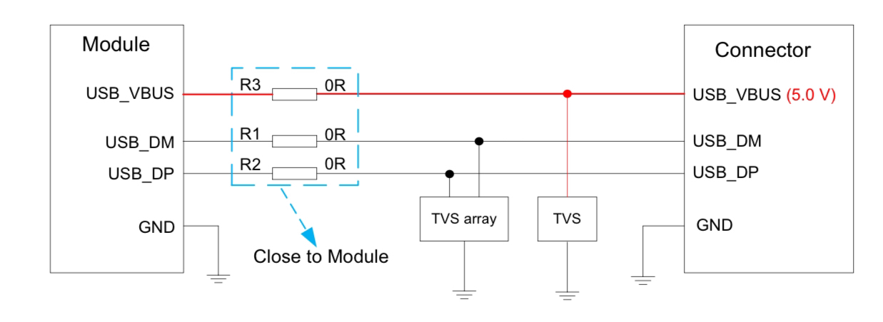

why would i need to put it in code format? there is no code involved as well as no error message because i simply cannot connect to the pc (at least long enough to transmit or receive anything) as for the hardware i can provide a reference picture from another project that has the same setup for it as for what is happening, i have no idea thats why im asking here.
Where is the Arduino in that diagram?
It’s not an Arduino, it’s an esp32-s3-wroom module and it’s to the left, as for the gpio3 well it’s not connected to anything during startup so not necessary in the diagram just know that it is floating
Ok, now that we have some documentation, maybe a hardware expert can figure out what you are trying to do.
i have an interesting find, i tried to check tvs again using multimeter in continuity mode and there is none but when i have the probes of the multimeter on the ground and on one of the didgital lines, it stops disconnecting. I dont really know how that makes sense to be honest.
