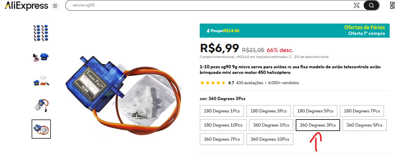

ESP32 Servo SG90 issue
Hi, I have multiple SG90 servos and when uploading the below code it does not rotate 180 degrees but spins multiple 360 degrees in both directions. I bought them from AliExpress Servo g9. I've created a video and placed it on YouTube Click to view video (I've only just uploaded it so give YouTube time if it doesn't load).
Any help will be appreciated. Thanks in advance.

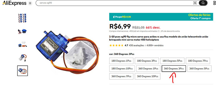

Unfortunately you bought the wrong ones
You have not bought servos
What you bought are continuous rotation "servos". You cannot control the angle that they turn to, only their direction of rotation and speed
Found a solution of sorts.I used this site to get ideas Drone Bot Workshop. I had to install the library from the site. It uses a value of 0 (fast clockwise) to 93 (slow clockwise) giving various speeds from fast to slow 0-93. I've found values 94-100 stops the motor. Counter clockwise is 101 (slow) to 180 (fast). I've just butchered the WiFi version down to it's basics that I can work with.
I have delays of 1000ms between actions but I've found that the clockwise turn is slightly longer than the counter clockwise. Further investigation and a look at the library functions will be needed. There are functions such as readMicroseconds and writeMicroseconds which could come in handy if they do what I think they do. I don't want to go down the path of reed switches or microswitches. If anyone has sample code which uses the library from this site Github ESP32Servo Lib to get accurate angles it would be appreciated. i.e. on a clock from 8-4 (twenty to - twenty past). I'll probably need to use a reed switch and magnet to to home it initially, but I just need accurate angles from the servos I bought.

Please describe exactly what you want the servo movements to be in terms of angles. Your "solution" will not work well in the medium to long term. Apart from anything else the rotation speed will depend on the load put on the servo
Just a basic cat laser toy. I've thrown a video of it on YouTube here It's scheduled to be released at 23:00 GMT. Take a look. I've used random numbers for delays and seems to work OK. I'm going to reduce the sketch by putting the movement in a single function, passing the Write value and the delay. That should shorten it. Here's the code I've used:-

Do yourself a favour and buy some real servos
It's a challenge. I love challenges :rofl:
Look on AliExpress and recommend some. I need accurate servos and you seem to know what you are talking about.
For your application, ie a cat laser toy, you do not need precision, so just about any 9 gram servo will be good enough as long as they are actually servos and not continuous rotation electronically controlled motors
I am not going to recommend any from Ali because I don't trust their descriptions. You would probably be better off paying a little more and buying from Ebay from a seller based in the UK. Before buying, message them and make absolutely sure that you know what you are buying. Even better would be to go to a local model shop in or around where you live and buy from there
