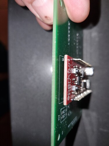

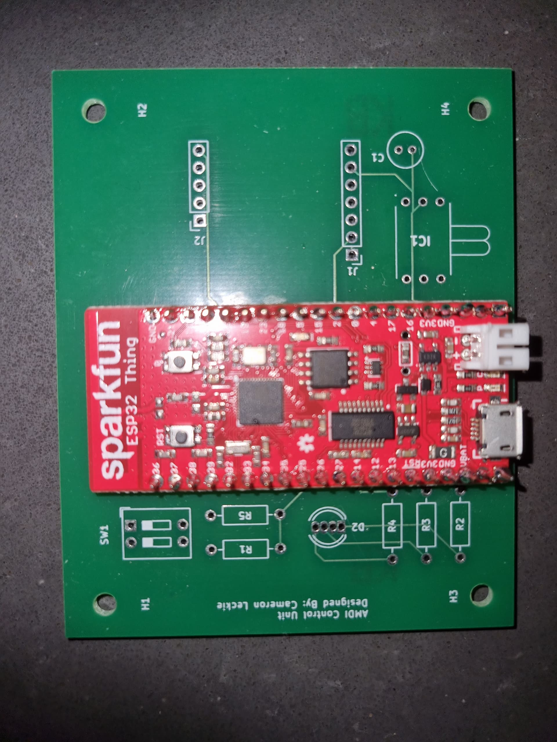

edit : Oh eh ? when you say soldered onto the PCB.. How much air is there between the PCB and the ESP32 board ? There should be no copper traces or Fill below or above the ESP32 antenna. It should be a keep out zone. If you used male and female header pins to connect the 2 parts that should be enough.

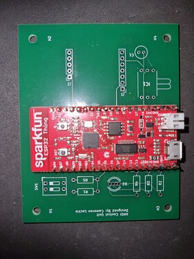

Please see two images of 'Setup 2':
Through my ignorance I have included a single track on either side of the PCB that crosses horizontally across the width of the WiFi antenna.
As you can see there is only a couple of mm between the PCB and the WiFi antenna as I have just used male headers.

Fixed.
I have added female headers. It is working reliably now.
Thanks very much Deva Rishi - greatly appreciated!!!!!!
The lesson, make sure that the ESP32 WiFi antenna is not near any PCB tracks!
