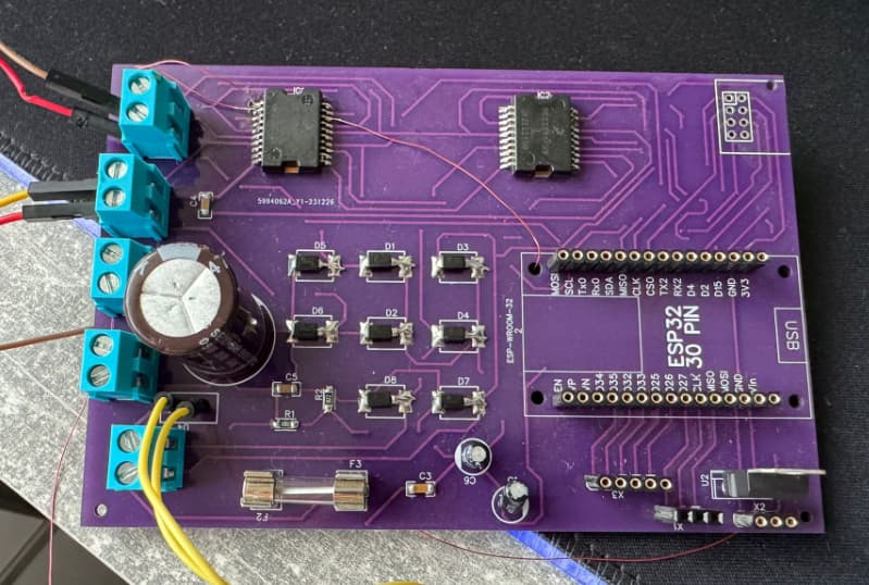

I have a little Problem. I am working on a school project and I ordered the MCP33886 MotorDriver for my own Board. I need to control the Driver with an ESP32, but it is not working. I have not much time left. I have connected the IN1 IN2 D1 D2 Pins to the ESP32 and I want to control it with PWM. A problem could be that the ESP32 has 3,3V output and the Driver needs at least 3,5V at the PWM Pins to work. Would be really nice if someone could solve my problem.

Okay I will try with 1kHz, yes the GND is connected, I connected AGND to the ground of the ESP32 and PGND all together. The drivers get 7,4V extern and the esp32 gets 4,9V. I use a function generator to send the PWMs with 5V, because ESP32 cannot do 5V
Are you using a MC33886 pre-made module/board or the IC in some design you made?
I am using the IC with a design which I made. It is for a RC Car Project
Then I suspect there is something wrong with your design.
We will need to see the schematics and PCB layout.

There is no bypass capacitor for each of the MC33886s.
Did you cut the PCB traces in order to connect the function generator?
this is how it loooks like right now, some traces were missing and I connected them here with the red one. I connect the funkction generator with the Pins from the ESP32
D1 and D1 are connected
