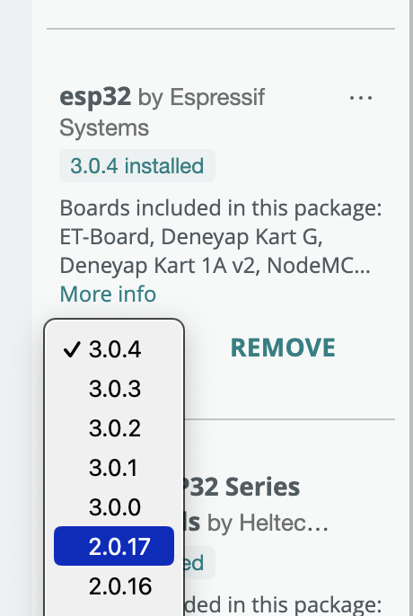

Simple to roll back, just nopen the board tab and click the combo box that is now showing 3.0.4. Click on 2.0.17 and done.
well, I've taken in consideration that option, but unfortunately doesn't appear so simple (to me) since when I connect the board via usb no serial port appear so I don't know how to downgrade it.
No board needs to be attached, here is what you should see
All that is happening under the covers is that the library code that is board specific is either upgraded or downgraded. I don't have anything attached to my laptop when I do this.
