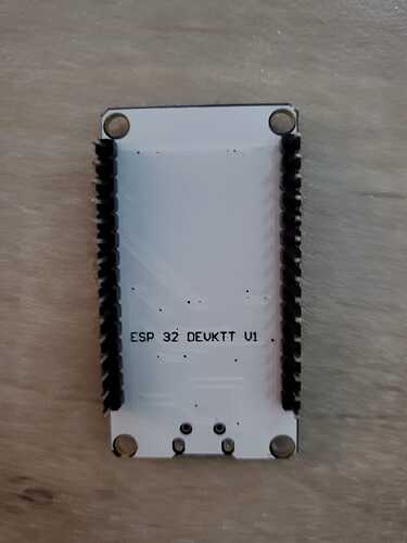

I am trying to upload the sketch to ESP32 DEVKIT V1 and face with the following problem:
"Connecting............
A serial exception error occurred: Cannot configure port, something went wrong. Original message: PermissionError(13, 'A device attached to the system is not functioning.', None, 31)
Note: This error originates from pySerial. It is likely not a problem with esptool, but with the hardware connection or drivers."
Some ideas?

SILABS CP2102
If it's a 38-pin version, try keeping the 'boot' button pressed from the moment compile is completed until the upload actually starts with a 2 way communication.
Thanks for the replay, but it still doesn't work. I suggest any USB driver issue. I work in Windows11 and use the last updated CP210x USB to UART version
If the port is visible within the IDE, then it is recognized. Cable can be an issue,
Can you show us the unit you bought ?
Ah yes those are a 30-pin, those are pretty good, don't know what's wrong, try a different cable and a different Hub maybe. The driver should be fine as well. What IDE are you using ?
Thank you, everyone. All I did was reduce the upload speed and everything was fine
What was the speed before ?
921600
Hmm well that works fine for me on similar boards, but maybe the cable is not to good or something with W11 or the Pc or even just the USB hub.
