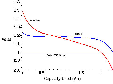

NiMH Batteries can supply more current than Alkalines batteries. See the graph.

Note from the graph shown that Alkaline batteries are down to under 1.2V half way through thier capacity, and only provide a higher voltage than NiMh for about 30% of their capacity.

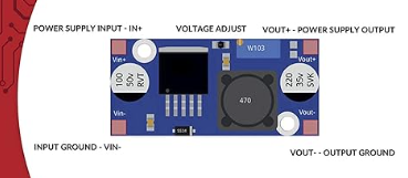

so I found this component (sorry I'm more a SW person)
https://www.amazon.es/dp/B07DP3JX2X/
with a multimeter I would adjust it to be 3.3V in the output.
also I've read that when the voltage drops a certain level I should add another component? or its not applicable anymore?
and about how to connect it, do you mean I have to connect everything to the 3.3 pin (sensors - output and battery power via component - input)?
You have two options.:
  • Connect the output of the battery pack to the ESP 5v pin (or the USB connector).
  • Feed the battery pack to a boost/buck (or just buck) converter, set to 3V3, connected to the ESP 3V3 pin.
