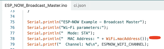

Try looking at the Board samples.
 ![Screenshot 2025-08-01 at 09.41.37](https://europe1.discourse-cdn.com/arduino/original/4X/3/a/2/3a22fb4d4f5cb7f32bf303da57e174bfaf1eca32.png)

I did but I dont see code that will only read the MacAdress.

Really, did you miss this?
 ![Screenshot 2025-08-01 at 11.07.16](https://europe1.discourse-cdn.com/arduino/original/4X/c/5/3/c53b53cd629487d16eff6aa2b519a093afc3621d.png)
The 'fix' to your OP is in that example.

Thanks.
Yes I missed it.
I will try the examples tomorrow.

The examples does compile , got a master connected to a slave.
