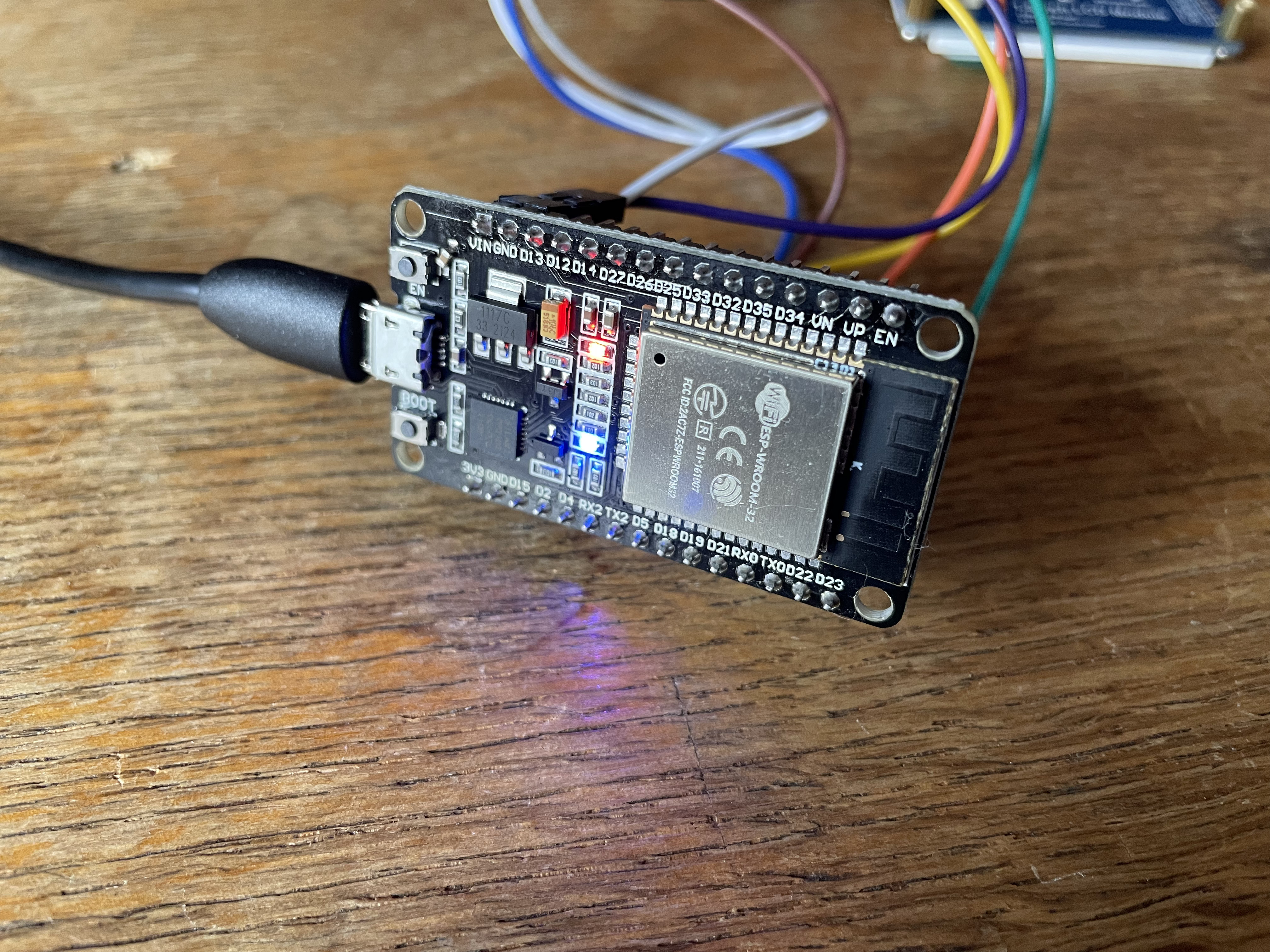

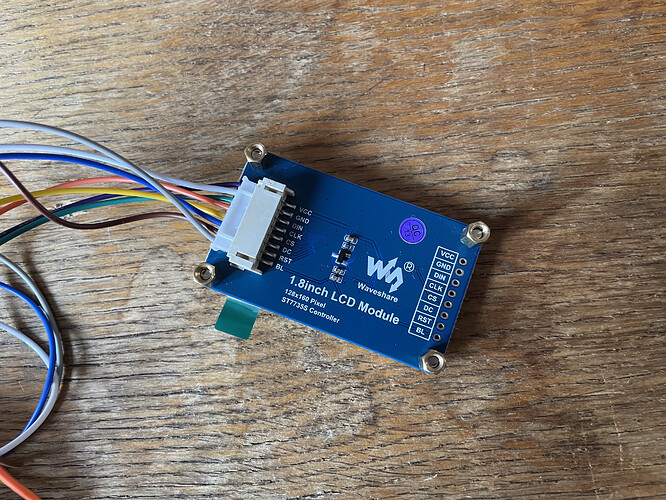

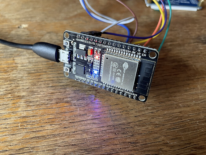

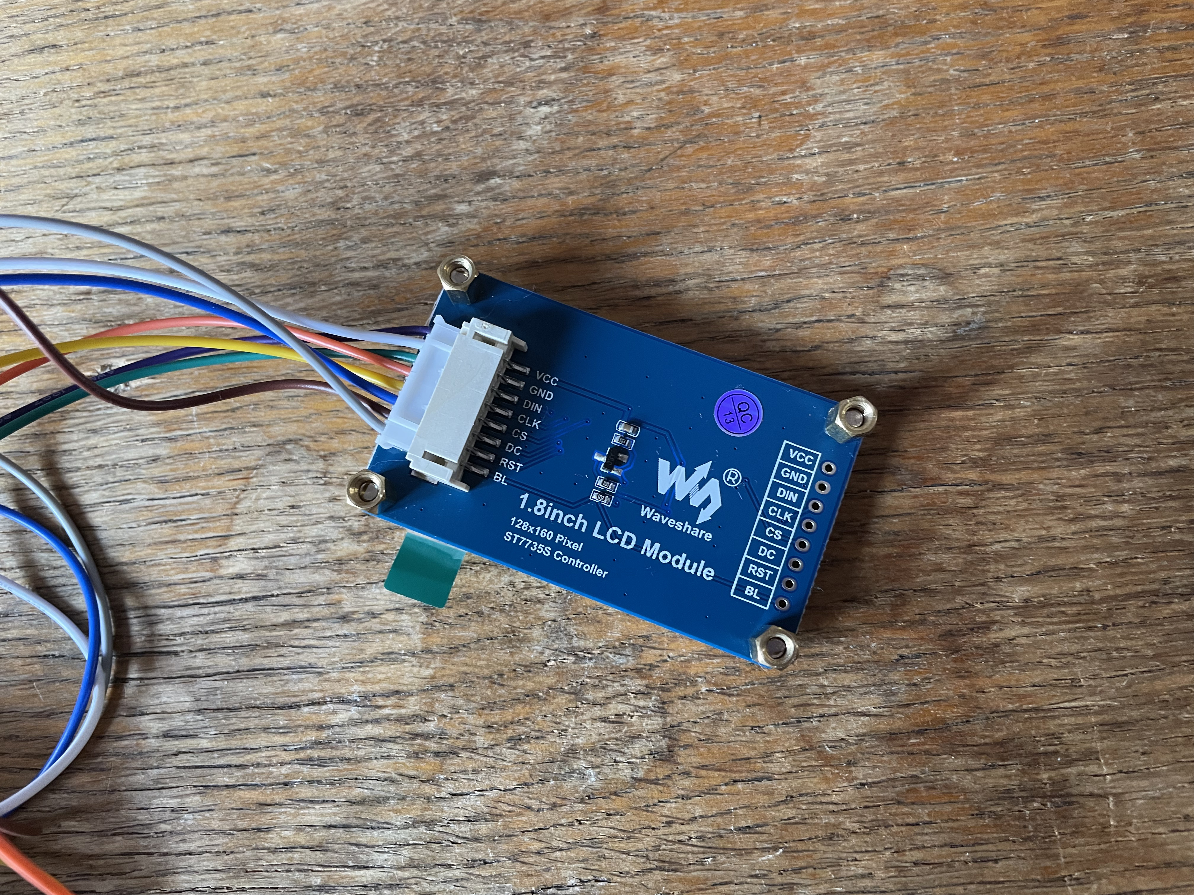

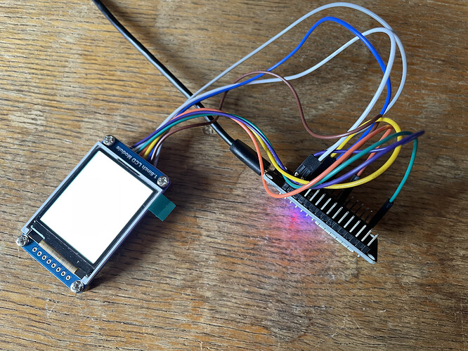

Hi everyone,
I am working on a simple project with Esp32 and LCD display (128x160 ST7735s). I connected two together and after plugging to computer both modules seem to work. Following the tutorials, I am working on running TFT_ESPi library to display some GIFs later. I've started from setting up User_Setup configuration and then I've tried to run some sketches from TFT_ESPi library, but no matter the settings, the display is blank white. I've looked through every thread possible, still can't find the solution.
Wiring:
VCC -> VIN
GND -> GND
DIN -> D18
CLK -> D23
CS -> D15
DC -> D2
RST -> D4
BLK -> 3V3

Here is my display:
https://www.waveshare.com/1.8inch-lcd-module.htm
And some photos of the project:
And again, User_Setup file, the one that worked for few seconds:

Seeing the internal LED is lighted, you are still using GPIO_NUM_2, which... see post#3
Here's how I got my e-ink wired up, 'GxEPD2_BW<GxEPD2_420, GxEPD2_420::HEIGHT> display(GxEPD2_420(/CS=5/ SS, /DC=/ 17, /RST=/ 16, /BUSY=/ 4)); // GDEW042T2'
Oh, sorry, I missed the response. Is it safe to change it to any other of numbered pins with the rest of the wiring? I'm going to try out your configuration.
I also am using only 3.3V for the e-ink display. The ESP32's GPIO pins are 5V intolerant.
Wiring it up anyway you want is not really possible. But using the ESP32's GPIO port A pins should work well.
Note, any pin of the ESP32 receiving 5V may be destroyed.
Very surprisingly, the project started to work after unplugging and plugging to the computer again. Now it displays all of the examples form the library.
But I became worried about the 5V pin. I have my backlight pin connected to the 3.3V, and VCC to VIN, but I am going to power the project via power bank. May it still be an issue? I honestly have no idea how to change it, and as I see your e-paper does have different pins.
VIN should be 5V. The 5V makes 3.3V which is sent to the ESP32.
From the Wiki https://www.waveshare.com/wiki/1.8inch_LCD_Module
it says you should connect VCC pin to 3.3V on a 3.3V system.
Waveshare don't seem to post a schematic. Can you read the part number on the 3-terminal chip ?
It is either a transistor (for controlling the backlight)
Or a 3.3V regulator (for the ST7735).
If your display works at all, your wiring must be correct.
How reliable are your jumper cables ? Loose connections will be fatal.
Once you get a reliable display, try GREENTAB, BLACKTAB, REDTAB, ...
