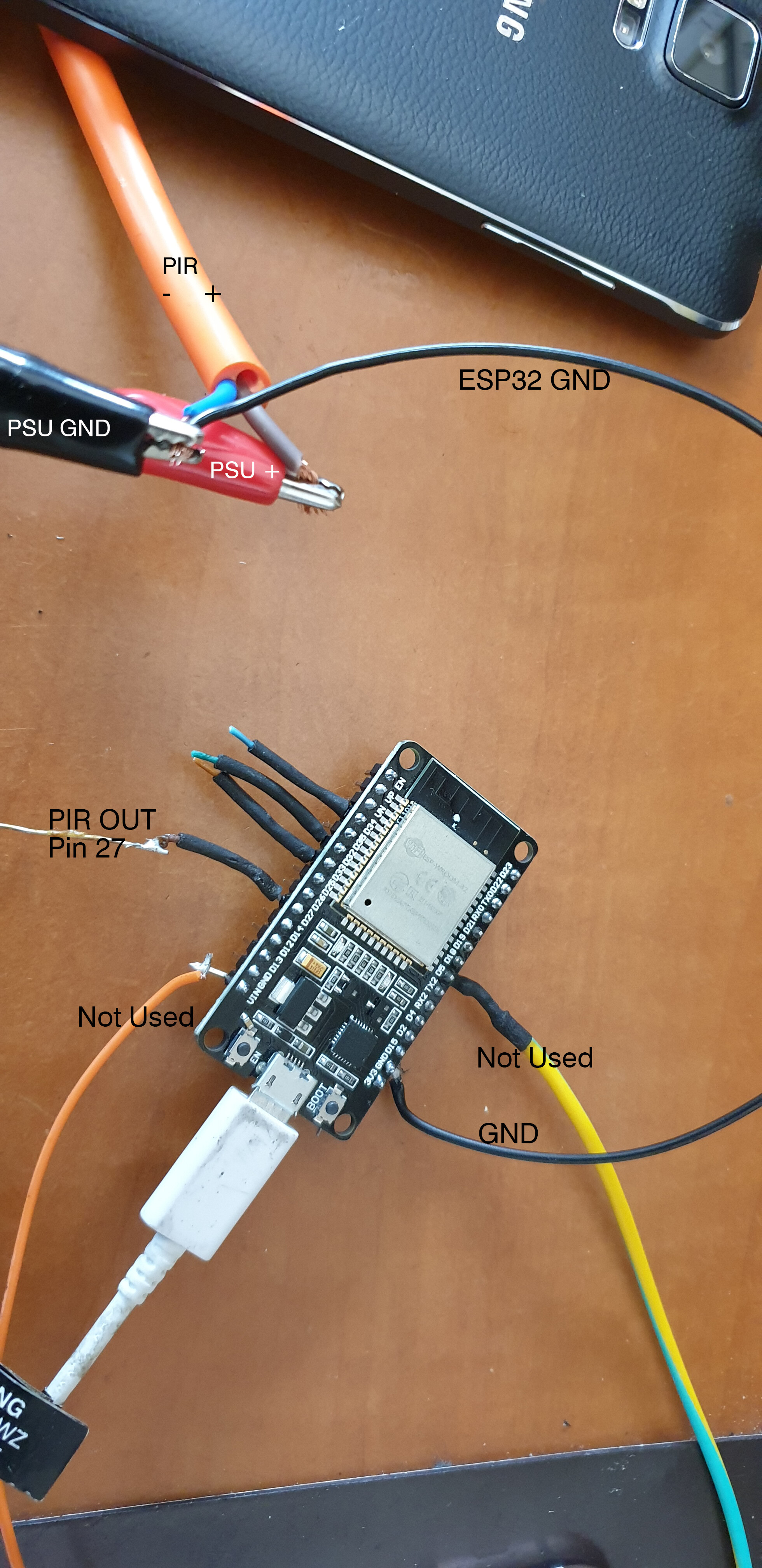

Next, post a photo of your circuit.
You do understand it is not an "option". The grounds (actually the negative pin which will be a black terminal, not the green) of all the different power supplies must always be connected together.
Sorry everything's a bit of a mess so don't know if the picture will be clear
Black and Red clips Bench PSU > PIR GND and VCC
Black GND of ESP32
Esp32 Pin 27 PIR Output
Yellow & Orange not connected.
That is a mess. Why not try using a breadboard?
Where is the PSU connection?
Why is there a wire connected to GPIO_NUM_17? GPIO_NUM_27 is on the other side of the developer module.
Don't know if this helps ive labelled the image. Sorry I didnt have a breadboard wanted to test the pirs spread out etc
