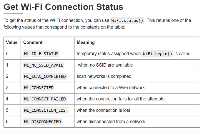

The above code is that I wrote a demo way. It loaded successfully and the connection to wifi ssid 1 seems ok. Thus it is capturing the internet router to use as WIFI STA mode. But after I try to turn off wifi ssid "Con co be be" and turn it back on, esp cannot automatically reconnect to wifi ssid 1 but it keeps hanging on WIFI AP mode with ssid "ESP8266_AP" . I have to hang it for a long time, from 5 - 10p, it can switch to WIFI STA with ssid "Con co be be" . Sometimes it can't connect even if I leave it for more than 5-10 minutes. It was an error that I understood because I was writing code indiscriminately without following the rules of programming.
Now that is exactly that kind of information that was missing as you started your thread.
The ESP32 can be configured in different ways which WiFi to connect and which not.
You can configure the ESP32 to keep a certain SSID stored on non-volatuile memory etc.
more serial printing will help to understand what is going on
one example how to proceed further
I linked to this tutorial
which has a table about the conncection-status
So one example is that you try to code how to print the connection-status
and even if this code does not compile to post this code-version and ask how it has to be corrected to make it work.
And this basic principle can be used all the time
Another thing is to ask "can somebody point to a link where there is information how to make use of this WiFi.status()-function

If, within some period, you cannot connect to a router then you can go on and try for the other router (just change 'credentials')?
Yes I understand, so how do I "for a while, you can't connect to the router then you can go ahead and try another router (just change the 'login info') ')?"

Rudimentary (no End of the World contingencies addressed) --
  WiFi.begin(ssid, password);
  Serial.println("Acquiring WiFi 1");//
  byte chances = 0;
  while ((WiFi.status() != WL_CONNECTED ) && (chances < 20))
    delay (500);
    Serial.print ( "." );
    chances ++;
  Serial.println("Failed 1st choice");
  // WiFi.end();    // Not Sure
  WiFi.begin(ssid2, password2);
  Serial.println("Acquiring WiFi 2");//
  chances = 0;
    delay (500);
    chances ++;
  //timeClient.begin();
Following Up --
It works (except I was re-declaring the 'chances' variable).
I used "mock credentials" for a non-existent router, which it fails, and then it goes on with life and picks up the live router (with ssid2, password2).
The previous 'works' because the first always fails (it's non-existent).
The following makes provision for the first choice connecting - and in that event it won't look for an alternative:
