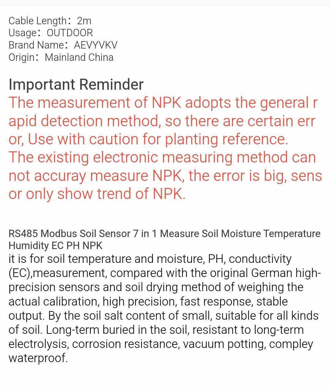

Maybe it's time to mention the elephant in the room.
The sensor you are using has been discussed many times on this forum. Many of the opinions are not positive. They say that the sensor may be capable of measuring temperature, humidity, conductivity and perhaps even pH with a degree of accuracy. But they also say that the sensor's ability to measure concentration of Phosphorus or Potassium is, well, bunkum. So maybe you should not worry too much about the readings for those particular parameters.
Devices that can measure just nitrogen are costing at least 4 digits.
7 in 1 doesn't lower the price.
thank you for the lesson sir even the manufacturer where I bought this sensor say so, it was also on their product description
I might include this on our project documentation
thank you for the help sir <3
