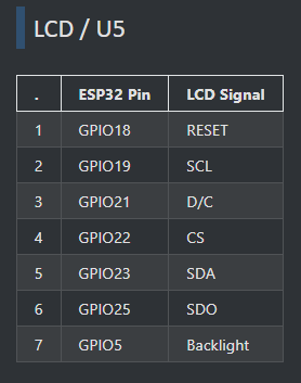

I'm using ESP32-WROVER-KIT v4.1 with the onboard ILI9341 LCD. The screen stays completely off — no backlight, no output — even when trying examples from TFT_eSPI, Arduino_GFX, and Adafruit_ILI9341. I’ve set GPIO5 LOW for backlight and verified all LCD pins from the schematic. Any idea what might be wrong or missing?

i hoping you used these pins and can you share the code you tried
Yes, Same pin i used.
I tried this code with both "Adafruit_ILI9341 tft" line one by one.

Do you have multimeter can you check the continuity of the pins are they loose connected or something try separately powering display by connecting vin and led to 3.3v and GND to GND the screen should go white or backlight should go on. if it didn't work the screen may have been damaged .
Post an annotated schematic showing exactly how it is wired, be sure to show J1. Show all power sources, grounds, and power. Note any lead over 10"/25cm.
