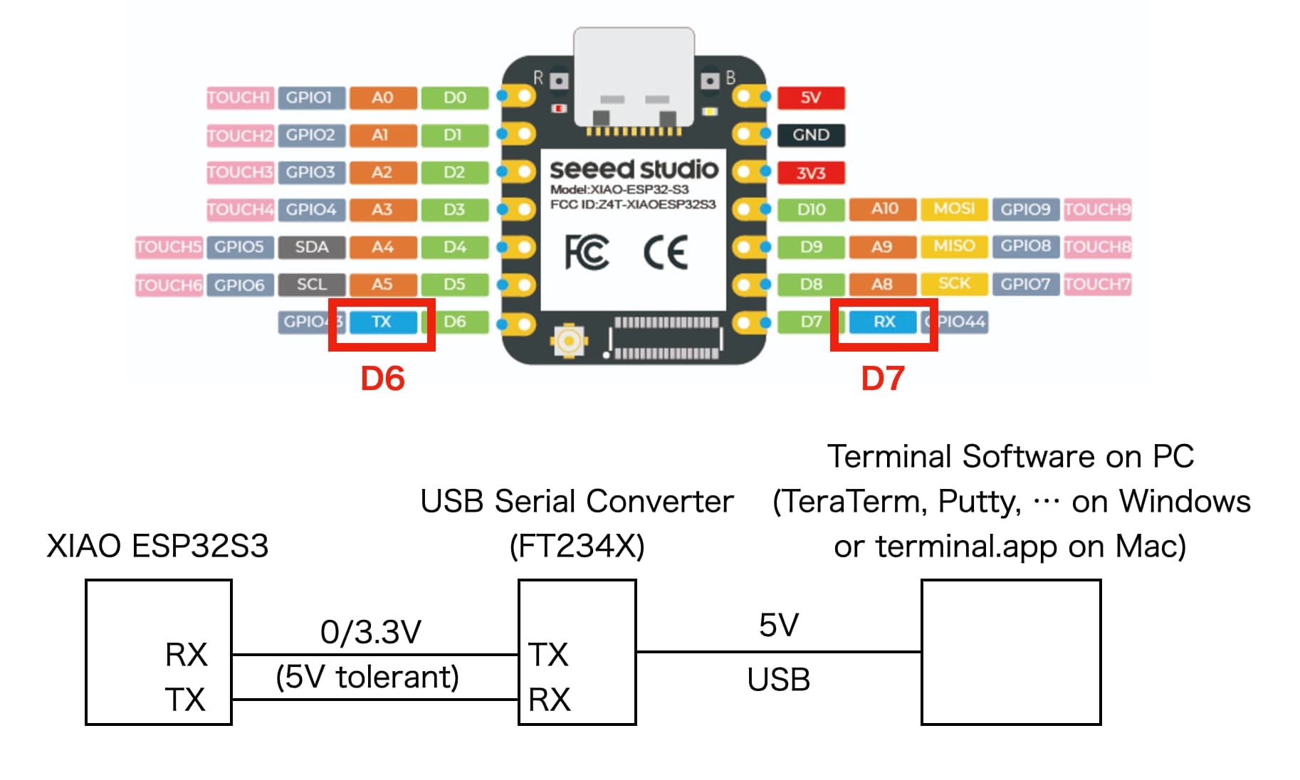

I have ESP32 XIAO S3 SeeedStudio with a PMS5003 Air Quality sensor and I can't achieve to make it work. I have uploaded the test firmware only showing the values provided by the PM5003 but when I open Serial monitor , nothing shows.
I am powering up the PMS5003 with the Volts output from the ESP32 XIAO S3. My main power source is the USB Port from my laptop
IMPORTANT: If i remove the sensor and upload a new firmware only sayin: "Hello World" by Serial port, this show correctly the text. What could be the problem ? I dont have any other components connected to the board

The serial you're reading from and logging to are the same object. That seems odd to me. How is your project wired?

You could try here: Pin Multiplexing with Seeed Studio XIAO ESP32S3 (Sense) | Seeed Studio Wiki
Look for "Serial1 Usage"
:wink: @6v6gt already answered...
I tested the sample code on SeeedStudio wiki with the following testbed, and found everything works as expected.
