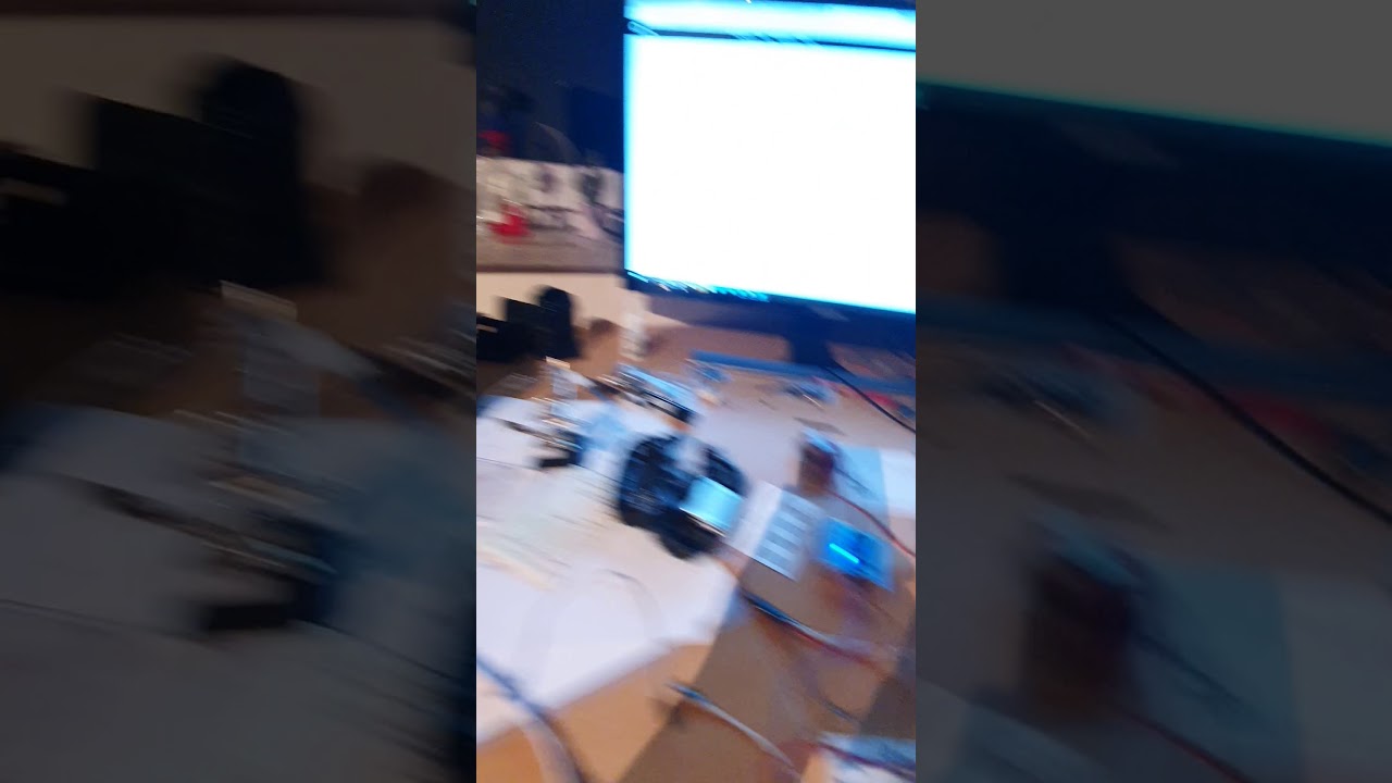

Using the library you provided leads to the same (NEW) problem i also have when using mine from above:
The servo moves, but extremely jitterish. It also draws about 0.7A, while it draws 0.2A using the servo tester. And it also runs smooth with the latter.
I thought the problem could be due to the logic level, so i built a 5v non inverting logic level shifter, but it changes nothing.
Servos behaviour can be seen in the vid:
zoomkat:
"Servo is receiving external Power."
Do you have a GROUND connection between the servo power supply and the ESP board?
Say no more. WTF ( MOD EDIT )
Spent like 3 hours trying... Forgot common ground.
So embarrassing.
Thanks so much
