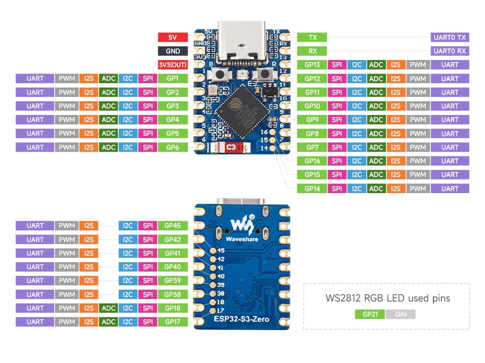

I'm trying to use pin 39 and 40 on an ESP32S3 zero mini for UART.
I did not get any UART communication through these lines when I tried simple sketches so I started debugging. I tested with a multimeter and found the pins stay high.
Even if I do this it still stays high.

It is this one: https://www.waveshare.com/wiki/ESP32-S3-Zero
There are pins on the bottom, too which arnt shown on that website.
This website does show the bottom: https://www.waveshare.com/esp32-s3-zero.htm
This is indeed my second prototype. My first one was successful but I decided to make it more compact and change the layout. So I changed some of the pin assignments assuming it would be fine. I checked this pinout diagram and it stated UART on pins 39, 40 which was why I thought it was a safe to use them.
I cut the traces from pins 39, 40 and connected the UART to 14 and 16 and the UART does indeed work on pins 14, 16.

I gave it a go on a fresh ESP32S3 zero with nothing else connected. I connected pin 39 to pin 40.
Then I ran the loopback test. It did not show anything in the serial monitor (I double checked the baud rate).
I then connected two other pins as a random test (I chose 17 and 18) and the loopback test works for those.

ran code of post 3 on a ESP32S3 Zero modified to use GPIO39 and 40 and the loopback test worked OK
how did you connect to the GPIO 39 and 40 pads on the back of the PCB?
not easy - I assume designed for surface mount
