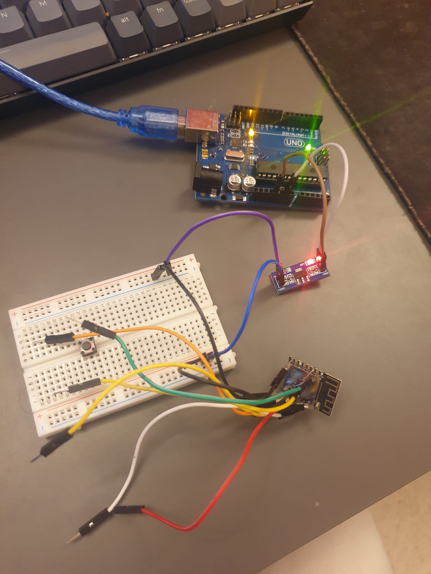

Oke let me show my current setup, this way you can give me clear feedback on how I'm messing up :slight_smile:
It looks a bit messy because of all the wires, but they were needed to program the ESP with my arduino.
Only the VCC and GND of the ESP are connected. I'm currently using my 5V power from my arduino through a converter to 3.3V to power my ESP.
Currently bothing is happening, I don't see my local hotspot popping up or anything.

If you are using an UNO you may as well just use it's 3.3v, but it is suspicious that your connection attempt causes it to crash, but i think i found the cause.
#define APSSID "paultest"
#define APPSK "test"   // this is not a valid password
#endif
const char *ssid = APSSID;
const char *password = APPSK;
A wifi password has to have a minimum length of 8 characters (and not all characters are allowed.
If that is the case the wifi credentials that were used last will be used, but those don't exist as yet.
Chage it to
#define APPSK "testtest"
Aaah that might indeed be a issue, when I get home Ill try to use the 3.3V of my Arduino as well as changing my password.
As for the string that is not like that in my code indeed.
Oke progress has been made! I now see the internet AP pop up and I now get the option to fill in the password. However it then just says, No internet, secured.
My setup now is 3.3V from my arduino, GND from my arduino and the EN pin of the ESP is connected to 3.3V as well.
