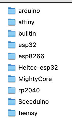

Here are the actual libraries under (user)/Library/Arduino15/packages
As you can see, I have a few additional entries in my boards manager URL's.
Screenshot 2024-09-27 at 12.58.43
so you use the Arduino's ESP32 core fork for the Arduino Nano ESP32. but that is an older version of the ESP32 platform
Please tell @k5map what your operating system is before he/she starts looking for Library directory.
Ah yes, sorry, that is on a Mac, not sure what it is on other OS. Concept is the same, just the names are different.
