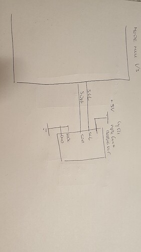

The code is quite raw still. I am using an MPU6050 on a GY 521 breakout board. The board has pull up resistors on board and a voltage regulator for 5V VCC. The thing is that the board does not have level shifters on board which were needed for the UNO but the Node MCU is 3.3V.
What happens is this. With the code above on the UNO I get a steady X axis value of +/- 0 degrees. When I check out the same situation with the Node MCU the values for X axis are 45 degrees and then jumping back to 0. Basically the go all the way around.
The schematic attached is not the greatest but I hope its clear.
Your schematic is exactly what we like to see. This is far more clear than any Fritzing pretty picture.
The SCL and SDA lines need a 4k7 pullup on each. Else you will get random erratic data.
https://learn.sparkfun.com/tutorials/i2c/i2c-at-the-hardware-level

Hi Steve,
Thanks for your reply. The pull ups were not drawn on the schematic since they are already on the breakout board. I measured 2k2 which to me seems a normal value for a 3V3 dataline?

It seems a communication issue somehow. I do not have a scope at my disposal unfortunately. So I cannot do any debugging in that way.
Please post images of the actual wiring.
So a quick test with the I2C scanner and the GY 521 breakout (MPU6050). With this I do get a valid address back without any issue. Only the values from the sensor are not correct in comparision with the same code on my Uno. See the hardware setup attached.
I had to use the 5V from the UNO board since the GY521 has a voltage regulator, and I was afraid that if I supplied 3.3V the voltage drop would be too big to make the board work properly.
I will re-build my setup for the BMP388 breakout board.
Thanks for having a look at it...
Attached my other setup to check the I2C bus with the ESP8266 NodeMCU and the I2C scanner strange outputs. This sensor has a 5V voltage regulator with levelshifters on board. So I needed to levelshift the logic levels back to 3V3 to be able to communicate with the node MCU. I have tried different power supplies but all results in the same issue...

The voltage regulator is a low-drop voltage regulator. You can power it with 3.3V and it might drop to 3.2V for the sensor. That should be no problem.
Is the black wire connected to XCL ?
Can you remove it ? Just leave AD0 open.
Can you replace all the wires with other wires and put everything in an other location on the breadboard ? Sometimes a breadboard has bad contacts and sometimes a wire is broken.
When you tried the I2C Scanner sketch, did you change Wire.begin() to use the specific pins ?
Thank you for your reply and your help.
Attached a new setup with the 3V3 supply, new wires etc etc.
Also with AD0 removed basically no changes. X and Y axis output values do not make sense at all.
