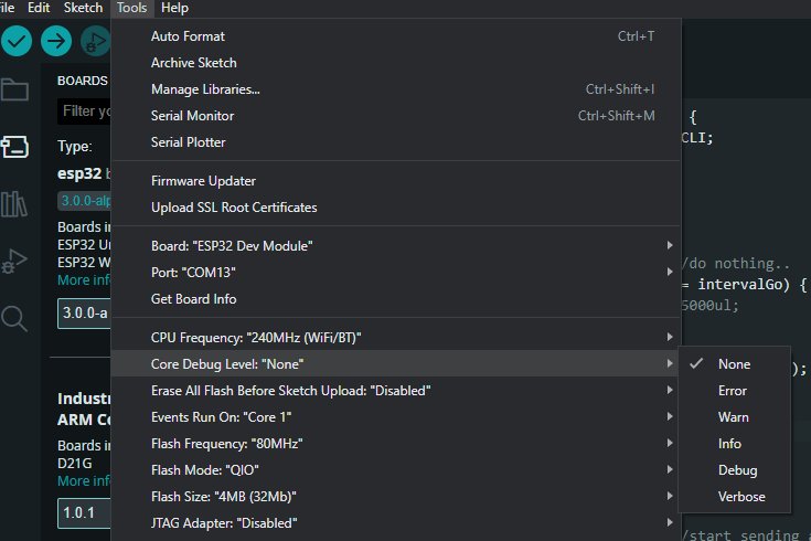

also not sure if it's there for esp8266..
maybe crank up the core debug level..
~q

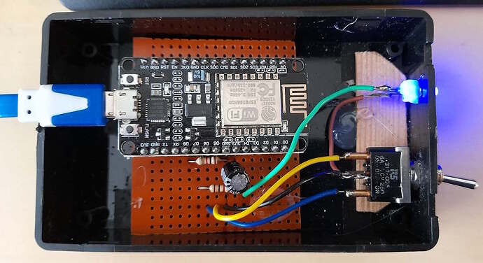

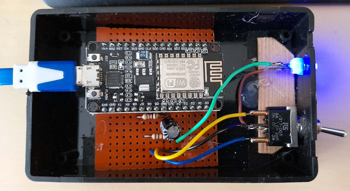

However I cant understand how the disallowed state can occur. Here is the schematic, and a pic

The wiring looks OK from the picture assuming the black wire makes a good contact with ground and there are no shorts on the underside of the board.

#include "webpage.h"           //simple web page to display
extern "C" {
#include "lwip/tcp.h"
#include "lwip/udp.h"
ESP8266WebServer server(80);  //create instance of server: need web page to give name on port scanner
constexpr int sX = D5;    //
constexpr int sY = D6;    //allow about 20% down time say 5 min intervals
constexpr int bLED = D7;  //blue LED to show wifi state
bool changed;     // flags if switch state has changed
int swState = 0;  //state = sX + 2* sY;  state 0 - off; state 1: on; state 3 timed downtimes;
int oldState;
int wifiState = 0;
unsigned long previousMillis = 0;  // will store last time LED was updated
const long onTime = 270;           // wifi on time
const long offTime = 30;           // wifi off time (seconds)
unsigned long changeTime;
int readState() {  //read 2 way switch state
  int locState;
  bool newX = digitalRead(sX);
  bool newY = digitalRead(sY);
  locState = newY;  //possible states are: XY 01, 11, 10
  locState *= 2;
  locState += newX;
  return (locState);
void flashLed(int rate) {  //indicate wifi connecting
  digitalWrite(bLED, 1);
  delay(rate);
  digitalWrite(bLED, 0);
  delay(rate);
bool connectWiFi(int rate, String message) {  //this is deliberately blocking code.
  bool success = 0;
  WiFi.begin(ssid, password);
  Serial.print(message);
    flashLed(rate);  //fast flash to show we are in the loop and trying to connect
    Serial.print("w");
  success = 1;
  Serial.println(" connected.");
  // Initialize mDNS
  MDNS.close();  //ensure to release the underlying UDP socket.
  if (!MDNS.begin("responder")) {
    Serial.println("Error setting up MDNS responder!");
  Serial.println("mDNS responder started");
  return (success);
//Handles http request
void handleRoot() {
  String s = MAIN_page;
  server.send(200, "text/html", s);
void logStatus() {
  struct tcp_pcb *tcpPcb;
  struct udp_pcb *udpPcb;
  uint16_t tcpCount = 0;
  uint16_t udpCount = 0;
  //for (tcpPcb = tcp_active_pcbs; tcpPcb != NULL; tcpPcb = tcpPcb->next) tcpCount++;
  for (udpPcb = udp_pcbs; udpPcb != NULL; udpPcb = udpPcb->next) udpCount++;
  //Serial.printf("Active TCP connections: %d\n", tcpCount);
  Serial.printf("Active UDP sockets: %d\n", udpCount);
  Serial.printf("Free heap: %d bytes\n", ESP.getFreeHeap());
  delay(5000);                                          //allow me time to clear serial monitor
  Serial.println("\n\n\n\n serial comms established");  //space after reset "junk"
  pinMode(sX, INPUT_PULLUP);
  pinMode(sY, INPUT_PULLUP);
  pinMode(bLED, OUTPUT);
  connectWiFi(200, "Connecting to WiFi network: ");
  Serial.print("Local IP: ");
  Serial.print(WiFi.localIP());
  Serial.print("  Signal strength (RSSI) : ");
  Serial.println(WiFi.RSSI());
  server.on("/", handleRoot);  //Associate handler function to path
  server.begin();              //Start server
  Serial.println("HTTP server started; setup complete");
  oldState = 4;  //force to process current switch state - max is 3
  server.handleClient();
  MDNS.update();
  swState = readState();
  //Serial.println(swState);
  changed = ((swState != oldState) ? 1 : 0);  //conditional ternary operator
  // if (swState != oldState) changed = 1;  else changed = 0;
  //now handle the states
  switch (swState) {
    case 3:
        if (changed) {
          Serial.println("State 3 : both off, WiFI going down");
          logStatus();
          WiFi.disconnect();
          Serial.println("wifi disconnected");
          wifiState = 0;
    case 1:
        if (changed) {
          Serial.println("State 1: X on \n");
          logStatus();
          wifiState = connectWiFi(200, "State 1: connecting WiFi: ");
    case 2:
        changeTime = (wifiState) ? (1000 * onTime) : (1000 * offTime);
        //Serial.printf("State 2: wifiState is: %i  changeTime is %i \n", wifiState, changeTime);  //prints every second
        if (currentMillis - previousMillis >= changeTime) {
          logStatus();
          if (wifiState) {
            Serial.println("State 2: Interrupting connection to WiFi \n");
            WiFi.disconnect();
            wifiState = 0;
            wifiState = connectWiFi(200, "State 2: connecting WiFi: ");  //flash rate, message
    default:
        Serial.println("Switch state 0 not allowed \n");
  oldState = swState;  //
  delay(1000);         //no need to debounce the switch
