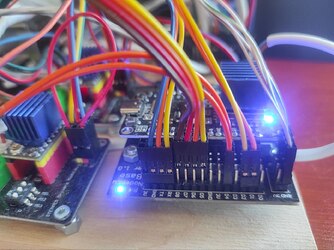

I have two nodemcu connected to different power supply. Nodemcu's connected to each other via rx/tx and use it to sync data + watchdog function,
code is no problem, but sadly i think it's way to long for someone to review it.
I don't have circuit diagram. Cause it's nodemcu lua board.

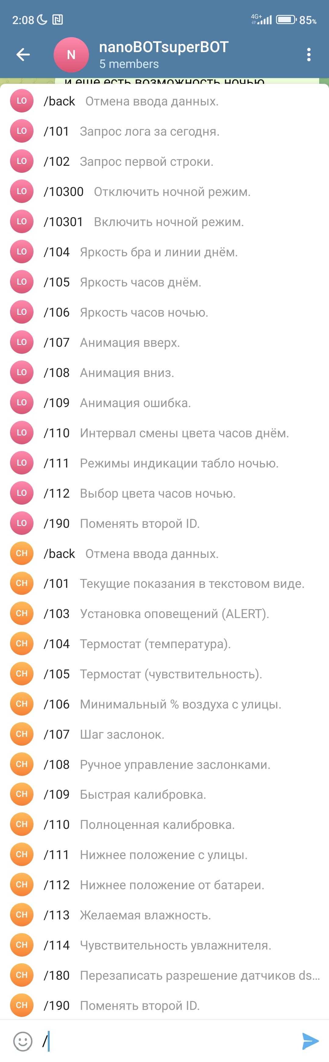

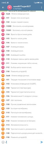

Full control via 4 different bots in telegram

This amount of commands... Some for debugging purposes, some useful.
I would say it hard for reading and understanding, and it is not a benefit.

You must be able to produce a wiring diagram showing interconnections .
Your board layout doesn’t look promising with high and low current cables overlapping .
With long cables you need to have optio isolation in digitals at least and strong Pullup / pull-down resistors .

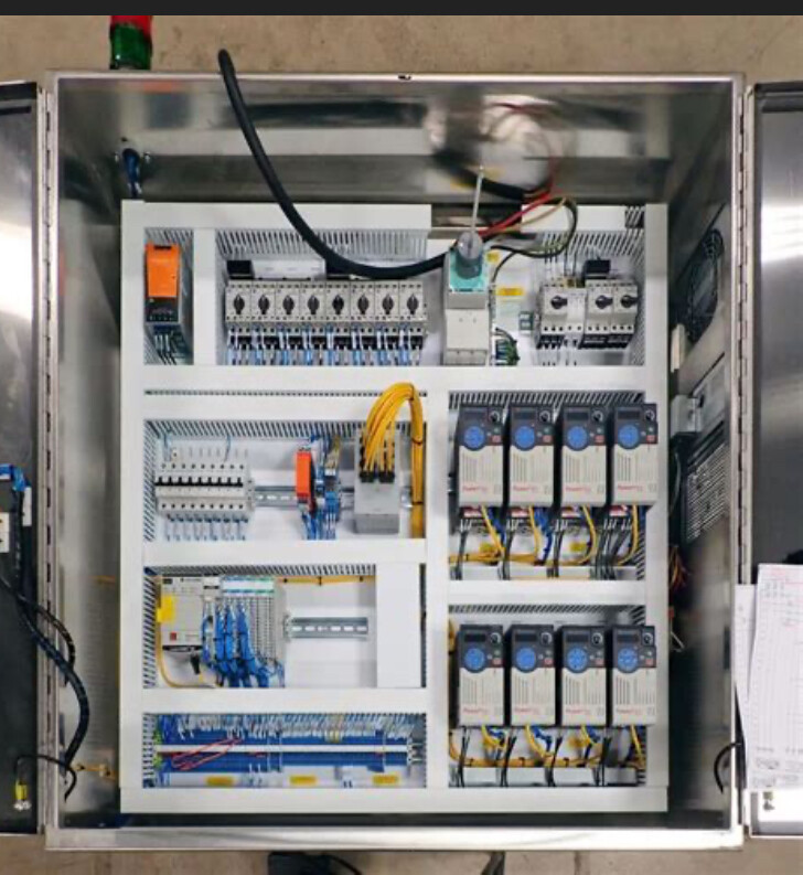

This picture is what you should aim for with high current and power supplies on one side and signals on the other Analogs should be in screened cable . Plugs and sockets can be very unreliable .

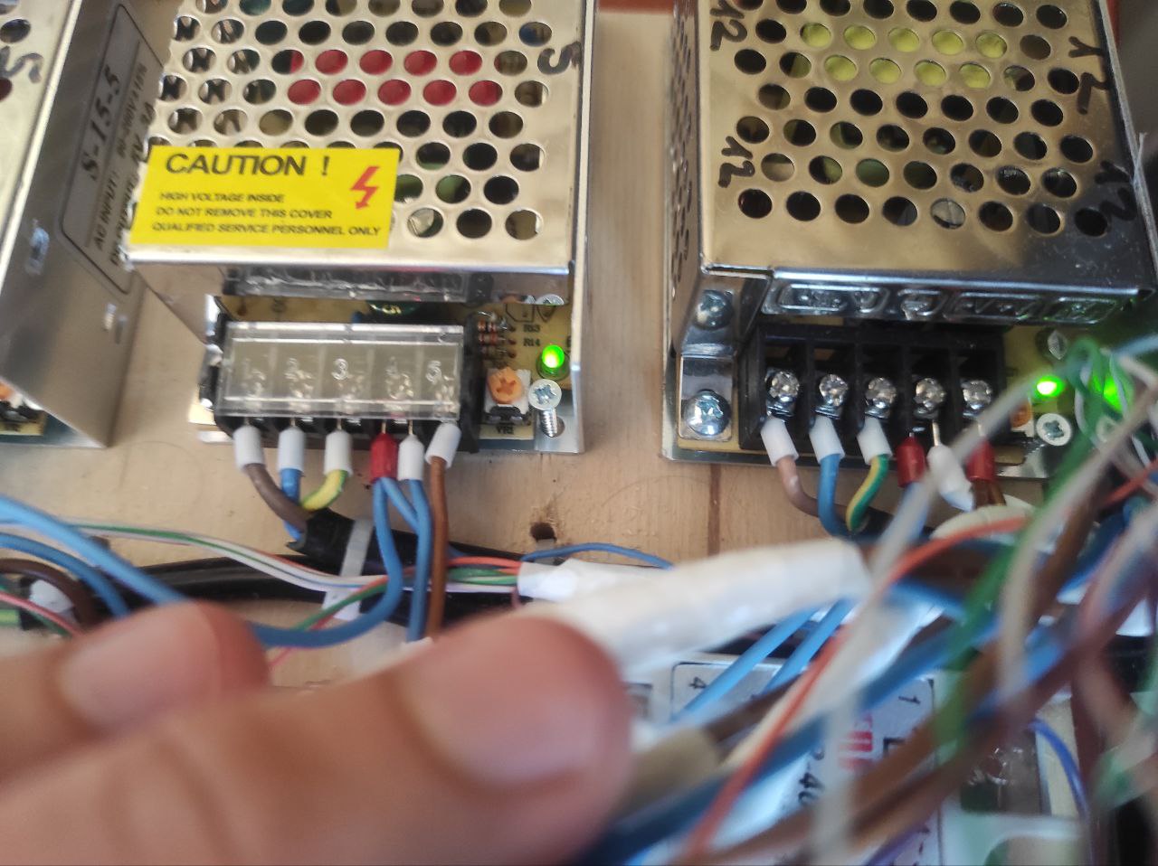

All “ field” wiring needs to enter via a terminal strip .

Wires need to be clipped !
Sorry if this is a but negative to you , but the benefits in terms of finding what is wrong will benefit

What is "clipped" mean? Shorten? Total length is long because physical distance is long.

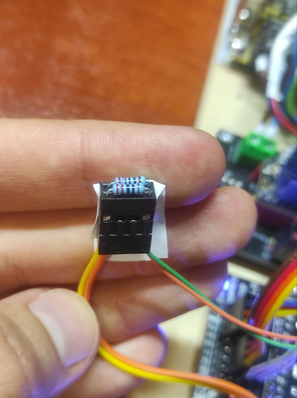

If understand correctly it allows light in one direction. I guess it won't work with DS18B20 sensors, that use OneWire. In my project longest cables are between nodemcu and ds18b20. From ~5 to ~8 meters each. 7 sensors total.
Yeap, i didn't know that either =0
For all data lines i used "Unshielded Twisted Pair" with ground/data and ground/+5v in pairs. It works well enough. I think i don't wont to rewire everything with shield wire))
i used either dupont connectors or soldering or terminal strip.

For ones wandering "WHAAAT ARE THOOOOSE" =0
it's "plug and play" resistors =0
i will solder them one day... i hope...
I’ve never thought of doing the plug and play resistors. Nice.
Thanks) they are perfectly fits in 4pin dupon connector))
And yeah, I'm slow, for sensors and led - I tried like 20 different resistors to define perfect resistance....
But, yeah, I agree that after prototyping is finished - soldering would be better...
The joys of prototyping.

spend few hours on cable management :
