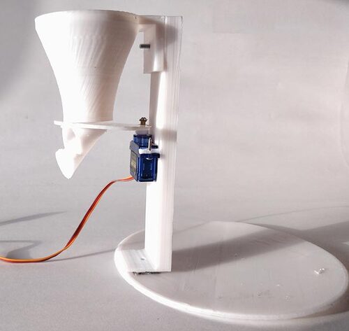

Hi all,
Very much a noob - trying to adjust a code so that a servo is triggered when the command !feed is said in my Twitch chat. This is to create an automated pet feeder.
I'm using this as a template: Twitch-chat-LED-lights/main at main · noycebru/Twitch-chat-LED-lights · GitHub
The bot and StreamElements are working okay, but I'm not sure my servo coding is correct...
I have tested with a simple servo code and that works fine. Signal is connected to D1 / 05

You only need to attach() the servo once. Do it in setup()
The same goes for Serial.begin() and pinMode()
Some of the for loops controlling servo movement make no sense
A prime example, but there are others
      for (int i = 0; i <= 0; i++)
        servo.write(180);
        delay(200);
How many times will the for loop iterate ?
By the way, your code as posted does not compile. One too many } at the end of it
Thanks for replying, I've made some changes to the code based on your suggestions:

I can't believe that you are still using for loops like this
As before, how many times will the for loop iterate ?
Oops, forgot to get rid of those.
I just want the servo to move once. The for loops were left over from the original code.

I have an SG90 servo - it's vibrating constantly. Are there servos that don't vibrate? Is it healthy for it to be vibrating if I have it running for a long time?
You could use servo.detach() after moving the servo but the output arm will then be free to move if a load is applied to it. What is it driving ?
Okay thanks, I'll try that. It'll have a small piece of plastic attached to it that will move horizontally to release the food with gravity.
Similar to this:
servo.detach() is working perfectly. This is exactly what I need, thanks for your patience and help.
