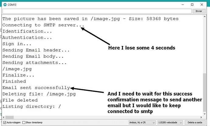

ESPcam. Always 3 attempts before taking the photo
I am powering my esp cam thinker with a steady 5 volts. Every time I reboot I see 'dirty' data on the serial monitor.
This code takes 1 photo and sends it via email. But every time he tries to take pictures and he can't, he'll only get it the third or fourth time.
I wonder why ?
Another doubt: If he starts to take the picture right away, the connection with the smtp server will be the second longest delay.
If I were to take several photos in sequence, what would be the method to maintain the connection? that is, not disconnect until I want to through some command?
I have a row of products and I take pictures one by one every 5 seconds and send them by email. It has to be one by one. So staying connected to smtp would be fine, disconnecting only when done with all the photos.

The ESP32 cam has to have a very stable and reliable power source.
How about an image of your wiring?
if you do this Serial.begin(9600); then
this
should be set to 9600. Better yet use, Serial.begin(115200);
It's all very messy here, but I'm going to reinforce the wiring, the power supply is good and it's also feeding an ESP32 wroom, 5 more would fit comfortably. I will still reinforce the threads, they are a little thin. And I have a 2200 uF x 16V capacitor on the output. Regarding Serial.begin I already tried 115200, 9600, 19200, etc.
It should resolve when I reinforce the wiring.
Does this also cause the attempts to take the picture ?
What does it take to keep me connected to an smtp server for several minutes while sending emails every X seconds ?
So that during the upload I don't have to waste time making a new connection, new authentication, etc.
what does the smtp server log files show for why the esp32 disconnected?
The code above is what I'm using to send a photo by email, when following the serial monitor I see it step by step and I see it connecting to the smtp server, then authenticating, then sends the photo and if I send another photo it repeats everything again .
I didn't see in the code how to interrupt any step regarding the smtp.
