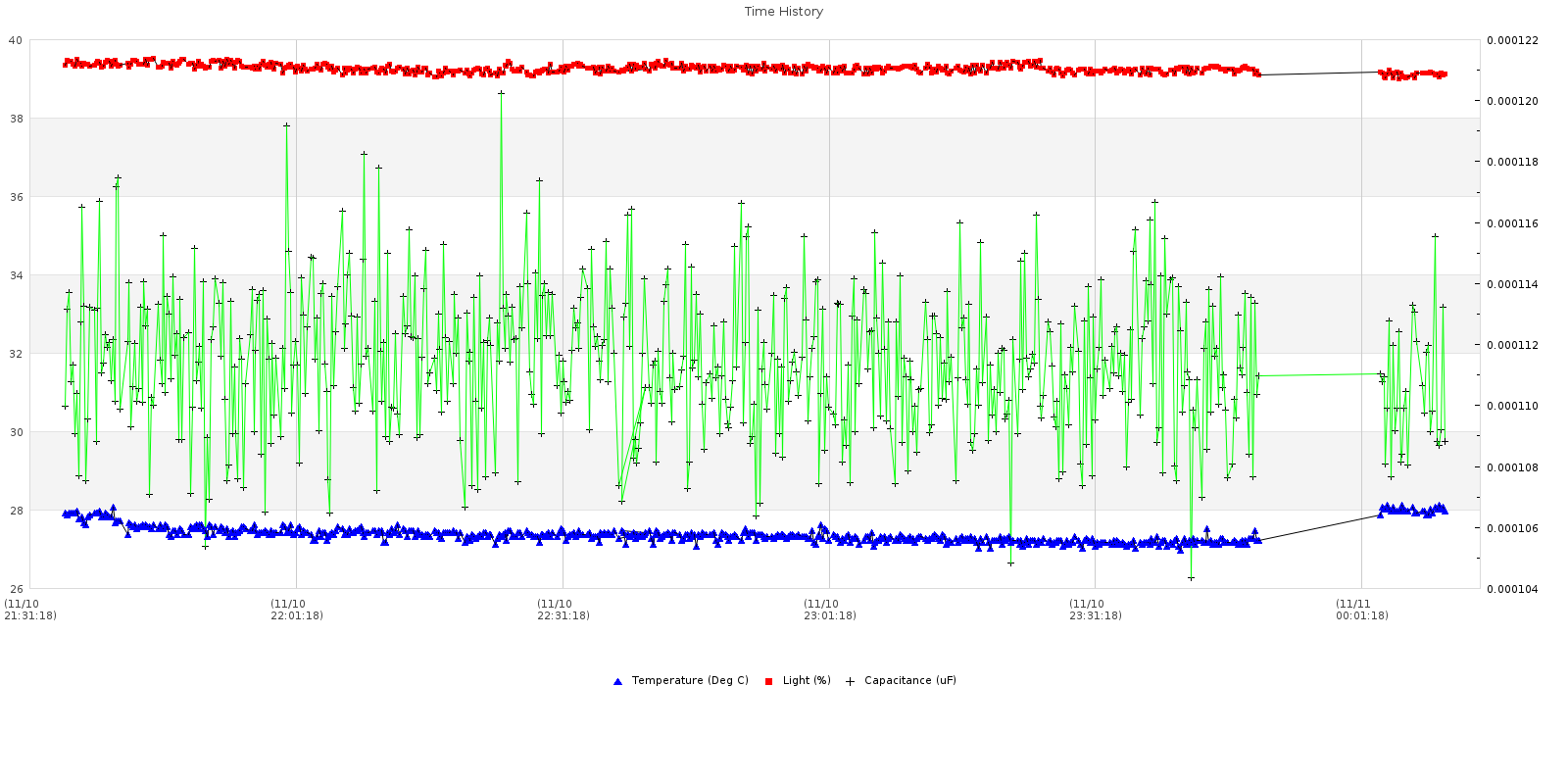

I have a lot of debug print statements since I am still developing this sketch. I started testing my sketch "on the field" by unplugging the USB cable and letting the board run from a wall power supply in a manner similar to how I expect it to eventually work. I noticed then that it would work for a few hours and then it would stop updating the server. You can see that in one of the attached pictures. One shows a clear gap before new data was sent again to the server after I did a hardware reset of the board by pressing the reset button on it.

The instability was in fact related to a power issue. I discovered it while troubleshooting a consistent offset on a temperature sensor that was sharing the same ground wire as the Ethernet module.
The solution was to provide the WIZ811 with 3.3v from the Vin pin via a separate regulator (lm317 in my case) and run a dedicated ground wire for the module from a GND pin on the Arduino. The voltage drop fro. The relatively high current draw of the 811 was lifting the ground plane of the sensensors. This affected the sensor readings and was causing the 811 to become unstable.
