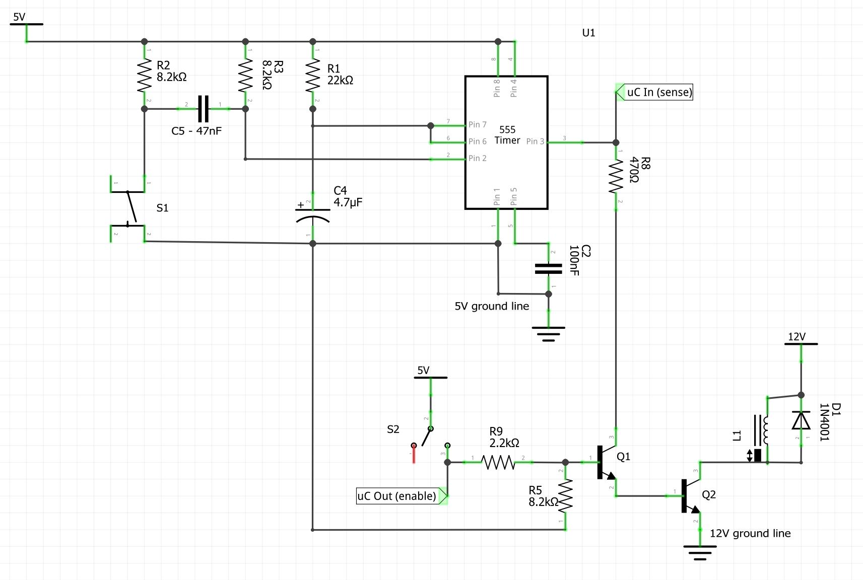

I am running into problems that seem to stem from excessive noise on the switch signal lines. I designed monostable 555 circuits to trigger several of the door lock actuators (TIP120 transistors) and they all like to trigger at the same time which to the best of my hobbyist-level oscilloscope detective skills is coming from noise generated by the actuators firing. The 12v and 5v rails have capacitors on them and actually look pretty good. When I put a lead on the positive end of one of the actuators (all have flyback diodes, drain to TIP120) I see the same severe noise as a lead on the signal lines from the switches.
Ideas/Attempts
I have tried a number of things, but the only thing that has shown some improvement so far is adding ceramic capacitors across the actuator leads (in parallel with the flyback diodes). Now the amplitude of the noise appears reduced and the other 555 timer circuits don't always trip, but they still frequently do. Increasing the capacitance with an additional cap in parallel seems to have diminished returns or no additional benefit. It seems that something as simple as a wire moving locations when I move the table as I'm working on things can be the difference between proper and improper function even with the caps installed.

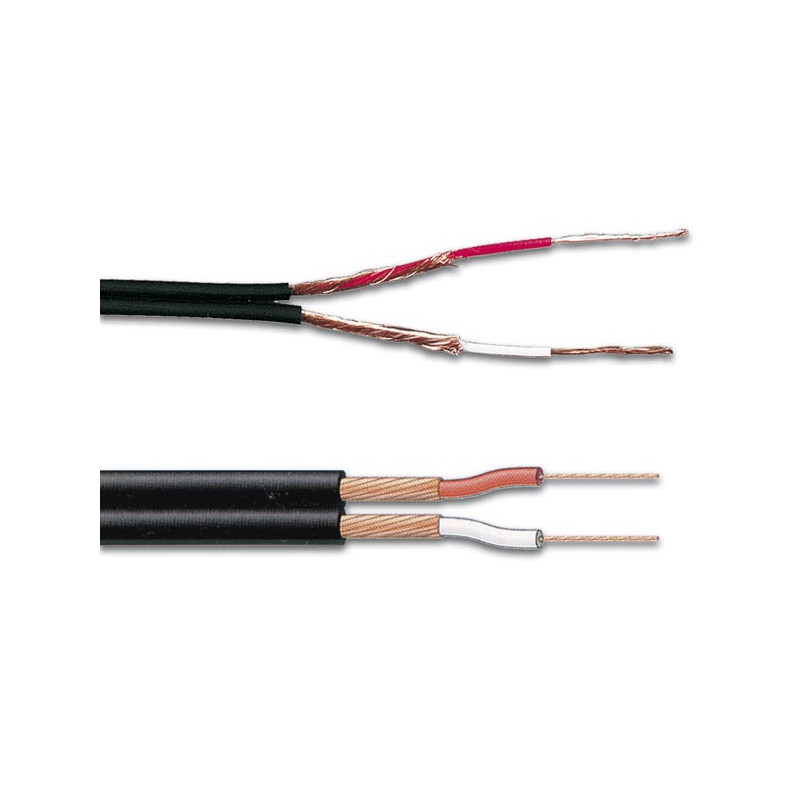

You're right, I haven't tried shielded wire yet. When I search for this, I get bulky cables with multiple wires in each. I have lots of signals coming from all over - is a single center strand shielded wire a thing? If so how do I find it? And would I be correct in assuming I use the shield to supply ground to the switch?

Do you think if I have a hard time sourcing appropriate shielded wire and I fix the wiring to be clean and a star configuration, that twisted pairs with one of the stands carrying ground to the switch or sensor would be a decent compromise to the same effect?
Something like
You can seperate the two 'wires'. 50 years ago or so, I bought similar as audio cable for stereo systems.
Have you got 0.1uF capacitor on each of the LM555, pin 5 to gnd?
http://neilwebber.com/notes/2017/03/18/555-timer-chip-and-the-importance-of-bypass-capacitors/
Can you post a copy of the LM555 circuit you are using?
Do the door latches share the same gnd wires as the controller and LM555?
Do you have back EMF diodes on the latch coils?

Okay, I should have thought to look for audio cable. Thanks!
Yes, I do have that cap.

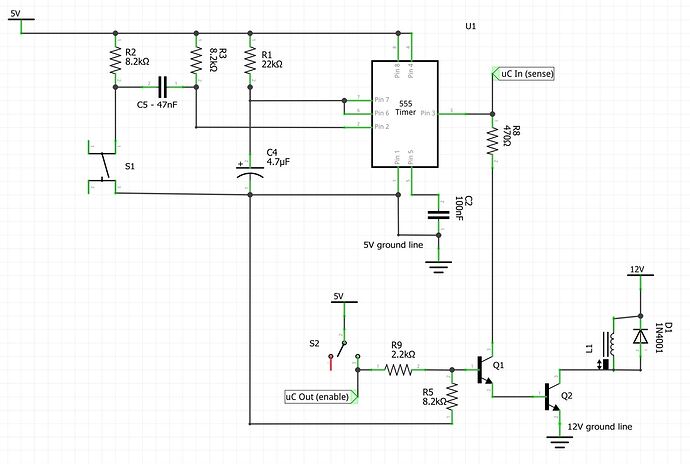

S1 represents my switches/sensors (usually a couple feet from the central 'hub', and frequently next to a door lock actuator or 12v coil represented in the schematic as L1).
Flyback diodes are currently at the supply leads that go into the door lock actuator housing (I haven't opened them up to mess with the internals). I haven't got a chance to read up yet, but it sounds like I need to move the diodes to the switching device instead.

The ground for the actuators goes to a TIP120, and all of the TIP120s are tied together with a wire headed straight back to the 12v supply. The supply currently (not the permanent solution) has sperate + and gnd leads running to an Arduino, which currently is only functioning to output 5v and ground for the switches/sensors at this stage as I am focused on working the noise issues out before I hook anything else up. I do have a 5v SMPS already that I will install to supply 5v lighting, sensors and logic.

This is gold! That would makes sense that the supply lines are causing more interference because the noise is generated at the switching side more than the load side. So I will definitely add diodes at the transistors. Is there any reason to pull the existing diodes from the load side where the ceramic caps are? It's obviously not much trouble to do so, but might as well leave them there if there's a chance there will be any benefit still once the diodes are added at the switching side.
I have 1000uf electrolytic and a ceramic next to the 12V supply, in addition to the ceramic cap in the nF range at the load.

If you are asking, then you have not looked! Every electronic distributor I know of has shielded wire.

I ordered some this morning, should be here tomorrow!
