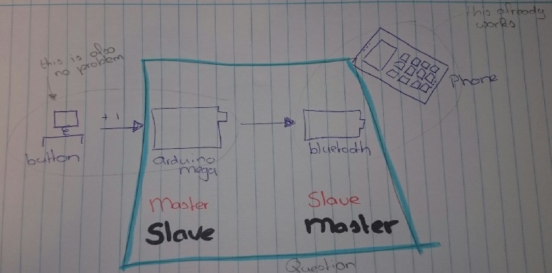

I have an ADAFRUIT FEATHER M0 BLUEFRUIT LE shield. This works well. Now, however, I want to extend this shield with more pins. I personally want to connect an Arduino MEGA, and then that i use the extra pins.

Is this actually a shield or is it a combined Arduino and Bluetooth board ? If so, then you could connect it to a Mega and communicate between the two using one of the available interfaces.

I put a photo in the attachment. I was now trying to figer out how I2C works.... Help is welcome
Okay, I'm slowly starting to understand I2C. However, there are still a few things that I do not fully understand.

I am curious about your input. In the attachment I put a small sketch with what I eventually want to achieve.
  • Does it matter which device is the Master? Because personally I find Master Reader / Slave Sender clearer than Master Writer / Slave Receiver.
You basically can have one master (multi master is possible though).
Depending on the device that you're talking to, you might need both Master Reader / Slave Sender and Master Writer / Slave Receiver. In e.g. an eeprom (the slave) you want to be able to write data and you want to be able to read it back; or you Mega might want to read from and write to your Feather (assuming Feather is the slave).

  • You specify at master Wire.requestFrom (address, bytes). If I do not know how many bytes are, how could I solve that?
If you don't know how many bytes, it will not work. So you need to implement a mechanism where the slave can tell you how many bytes there are before you can read the actual bytes.

As said, a little outside my league for the implementation but the general idea
master writes a command to slave (e.g. 0x01)
slave knows that this means: give me number of available bytes
master sends read request to slave to get the reply (read one byte)
master read the reply and remembers the number
master sends e.g. command 0x02 to slave
slave knows what this means: give me the bytes on the next read request
master sends read request (for number of bytes indicated in first step)
master reads the reply and stores the data in an array of sufficient size.
There might be other ways.
I did it. Just strike on the fact that I can not send larger numbers yet, but I will create a new topic for that question.
thanks for your help
