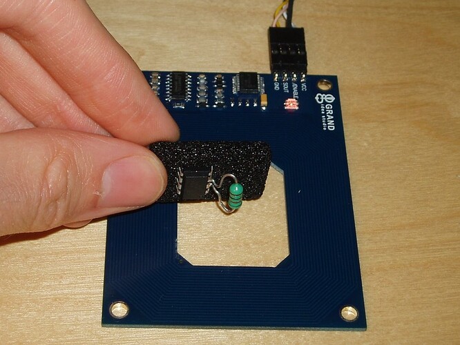

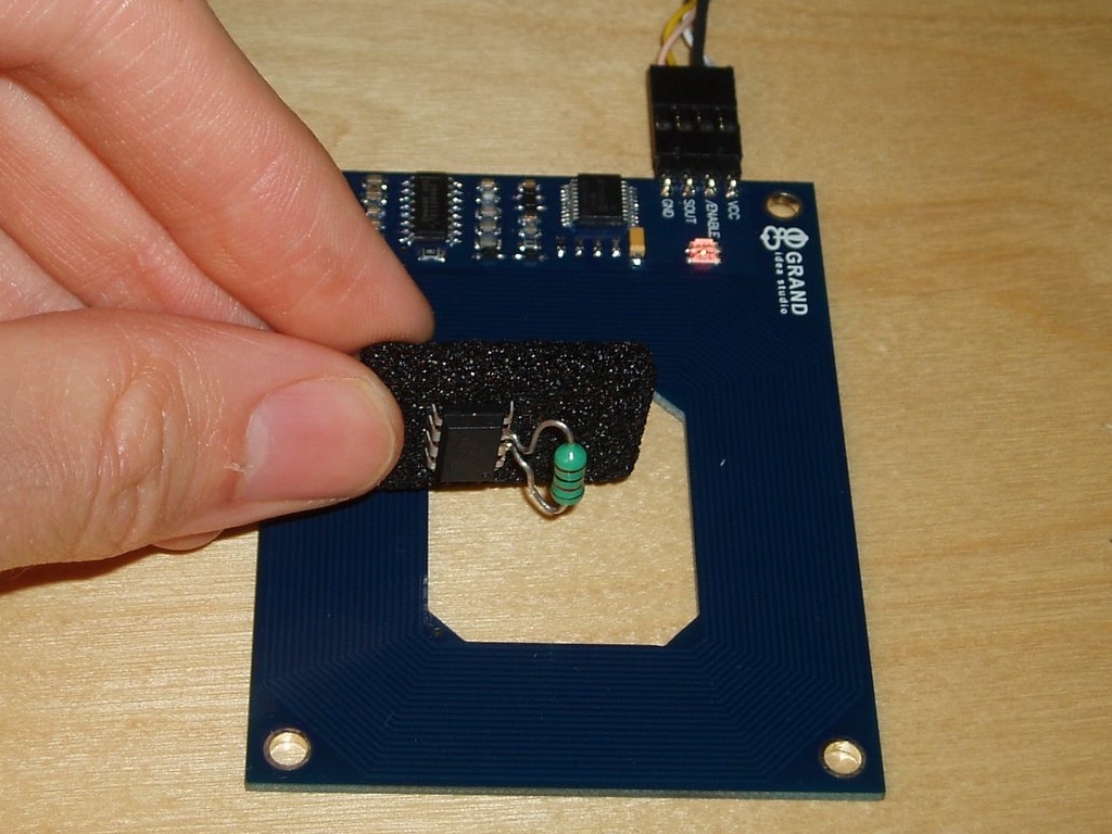

Or an external oscillator. I've even used an audio oscillator to fix problems like this. Programmer frequency must be set to 1/4 or less than the oscillator frequency.
The oscillator input on an AVR MCU is remarkably tolerant. For a laugh, check out how a complete, functional RFID tag can be realized using an antenna coil as the clock input to _and power source for_ an ATTiny, and **nothing else**.
> **[Using an AVR as an RFID tag – scanlime](https://scanlime.org/2008/09/using-an-avr-as-an-rfid-tag/)**
