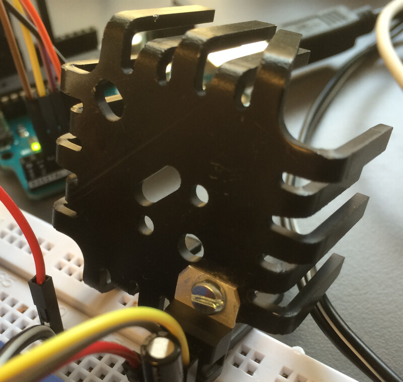

I went for the suggested solution with the LM7805 voltage regulator surrounded by a couple of capacitors and a nice big heat shrink. The regulator really gets hot without it. For the capacitors, I just used the "typical application" example in the data sheet. Seems to work out just fine. At the same time I've also implemented the 0.1uf capacitor on each analog pin.
In the process of making a wiring diagram for you guys I did re-wiring of my setup. This apparently did the trick! Now, everything is working perfectly with the sensors being powered from their own power supply and the Arduino from the USB socket. Other than the voltage regulation I don't think I did anything different so perhaps I had a bad wire or something in my first setup.

The heat may be reduced if you can reduce the feed voltage to about 7v. What are you using to power it?
Weedpharma
Currently I'm using a 9V power supply. With the heat shrink attached it's getting just a little bit warm but nothing more than just a little above body temperature. But then again, the heat shrink seems enormous in size compared to the little regulator (see picture) :slight_smile:
The project is a part of an installation that is supposed to be powered on 24/7 for several months so would the heat be an issue for the components in the long run?
That heat sink should keep it cool enough. 24/7 should be ok also.

Just an observation of words:
heat shrink would make the component warmer,
while heat sink will help cool the component.
By viewing your image, I see you really meant heat sink.
