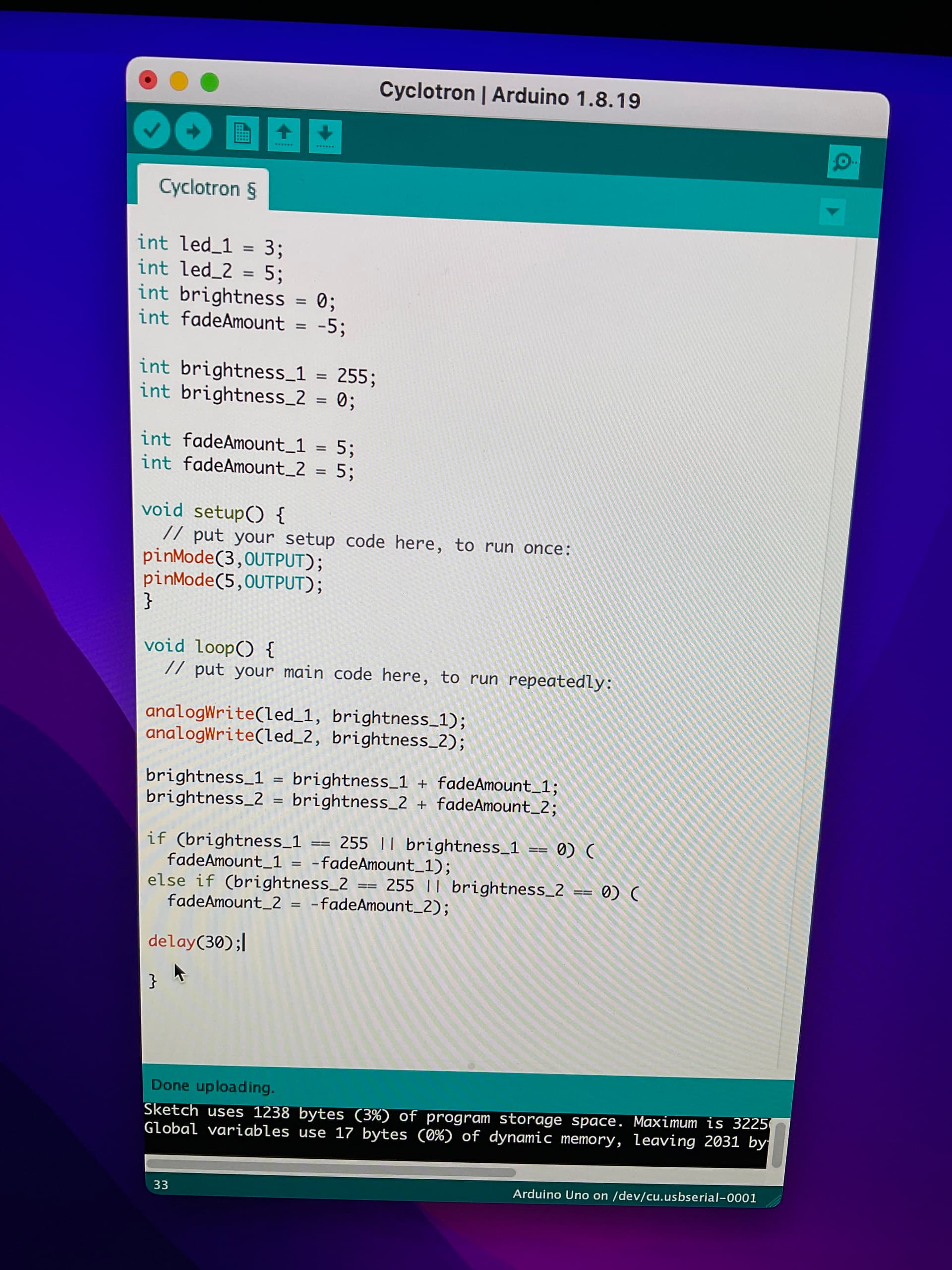

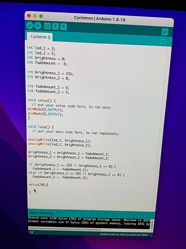

fadeAmount 4 leds
Hi all,
I can’t figure out how to fade (4) leds individually from bright 255 down to 0. For instance led_1 HIGH then fades to LOW, next led_2 HIGH then fades to LOW and so on..I think the delay30; is screwing up the sequence.
I tried an example with 2 leds with the programming attached but the sequence isn’t working right. I am hopeful someone can fix me here.
Thanks!

To your question:
I would use my LED Tooklikt, see the heartbeat LED if the effect meets your need. It can fade in/out several LEDs in parallel. Examples are provided in the library.
In general, no delay() needed.
Use millis() if you don't want to block your code.

Look at File -> Examples -> 03.Analog -> Fading
Take the "fade out" part:
  // fade out from max to min in increments of 5 points:
  for (int fadeValue = 255 ; fadeValue >= 0; fadeValue -= 5) {
    // sets the value (range from 0 to 255):
    analogWrite(ledPin, fadeValue);
    // wait for 30 milliseconds to see the dimming effect
    delay(30);
Duplicate that for the four pins (or use an array of pin numbers and a loop to run the same code four times with four different pins).
    analogWrite(led_1, fadeValue);
    delay(30);
    analogWrite(led_2, fadeValue);
    delay(30);
    analogWrite(led_3, fadeValue);
    delay(30);
    analogWrite(led_4, fadeValue);
    delay(30);
