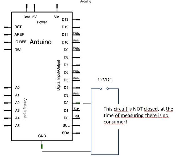

But what happens if the push button of the tutorial above is replaced by some other mechanism to close the circuit? (you know tutorials are nice to learn... but reality is more complex, right?!)
Like in my case a contact that is itself a part of different (open) DC circiut. Since I am only touching one side of that different circiut I thought it will not influence my Arduino circuit. Am I wrong???
I attached a picture hoping it makes this more clear...
And if I am wrong: what is the solution? Is it to simply add a resistor? (and why???? is there an electrical current in that case??? From my understanding I could use a 12V car battery or a 100V battery contact to close the Arduino circuit - and it should not affect anything as long as I only touch one contact, either + or -)
Thanks again for any ideas - hopig this all doesn't sound absolutely crazy.
Always ready to learn...!
If you connect the input pin to 12V you will damage it.
Your diagram does not show anything so it is hard to say if you are doing this. Any chance of a real diagram? That one does not make sense.
Connecting only one side of an external circuit will not work at all.
Electricity comes in various shapes. When a circuit shall work, it deserves 2 lines through which current can flow out and in again.
Current can flow also between one contact and earth, when it finds an path of possibly high (but finite) resistance back into your device. You may notice this effect when you touch an electric fence or the wrong (hot) contact of a wall outlet.
And AC or pulses can flow through non-conductive material, air or even vacuum, that's how capacitors and touchpads work.
But then there is wireless operation, where an electric field causes current flowing through a single line (antenna...). A cable connected to only one pin can catch such fields, most probably at 50 or 60 Hz, depending on your mains frequency.
And last not least there is static electricity, which can easily damage electronic devices. Simple movement of non-conductive material (plastic bags...) can cause a voltage of several kV, which finds its way as an electric spark as soon as you approach a differently charged device.
These effects can occur in any combination, and deserve different protection (grounding, isolation, shields...) to eliminate unwanted effects.
As G_M says that pic doesn't show anything, but...
I think we could help if you draw out the circuits properly. First draw that 12V circuit just by itself, then show exactly how and where you're touching it and the Arduino together.
Looks to me like you have that other circuit's -ve hooked to Arduino GND and then are touching its 12V to the Arduino digital pin? As G_M says, that's not good and is sure to release the magic smoke. Not sure though, from your pic.

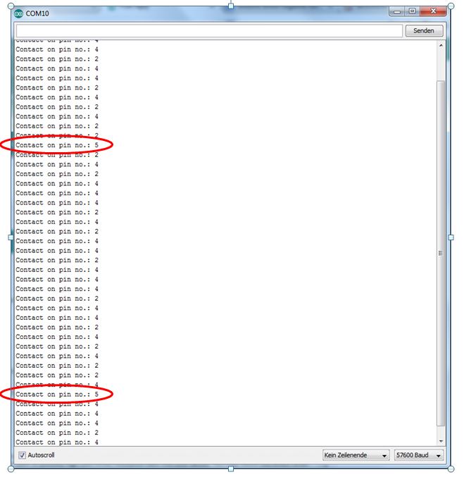

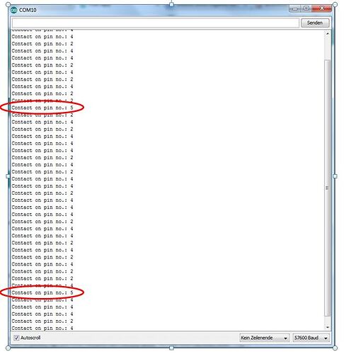

now, here is what I did and it is really NOT amusing me:
  • I unpacked a brand new(!) Nano
  • I soldered 5 cables to it: 1 for GND (left of D2) and 4 cables from D2 to D5
  • I stripped the insulation from the ends of the cables
  • I uploaded a simple test sketch which you can see below
  • I started the serial monitor
  • I connected the unisolated GND-cable in my right hand to the blank cables of D2 and D4 in my other hand (just running one blank over the other two, more or less randomly, expecting only signals from D2 and D4) - so I simulated the contact(s) in my real environment (I guess anyone did something like this before...)
  • and you can see from the attached screenshot of this experiment that the BRAND NEW NANO shows the same errors/problems that I had with the one that I already threw away because I really thought only a single pin wasn't working fine. NO! It was not the pin - it is definitely the Arduino as this experiment clearly proves, doesn't it?!!
  • The only 2 thoughts that are (currently) left in my head are:
    (and I always appreciate your comments on this)
  1. I did not tell yet (because I never that it might be of importance) that I use a cheap edition of Arduino Nano from ebay for 3$ - it says it is 100% compatible with the real one. Do you think this could be the reason?
    Anyone using cheap HW and ever experienced this (if recognized at all.....)??

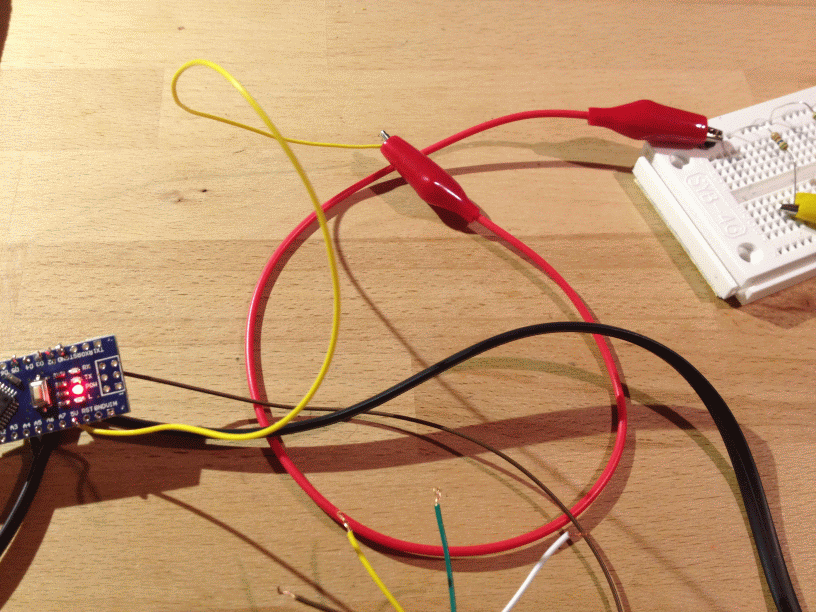

Can you proved a clear photo of your soldering to the 5 pins. I'd be suspicious of a poor connection and possible high impedance shorts to other pins or ground.
Also, try DrDeittrich's suggestion.
The internal pullup resistors (mode INPUT_PULLUP, 20-50k) may be too high for your environment. Try connecting all input pins to Vcc by some lower resistors, down to e.g. 220 Ohm depending on your sensors connected later.

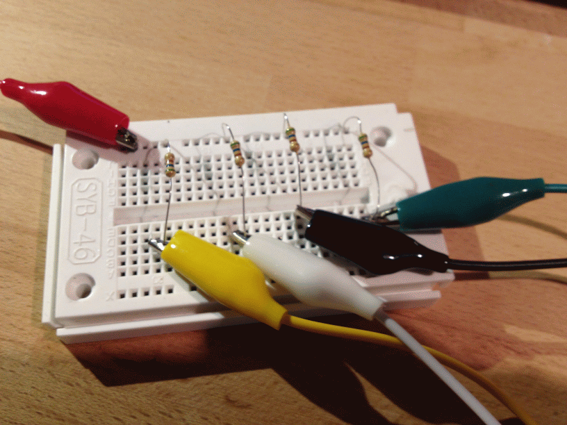

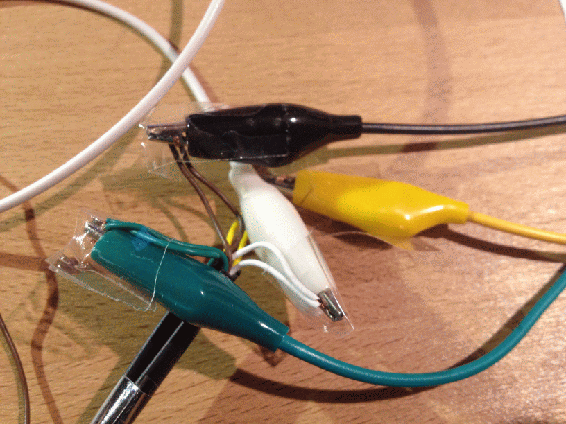

Hello DrDiettrich, hello cattledog,
I have followed up on the idea of DrDiettrich:
I switched to INPUT mode (instead of INPUT_PULLUP) and used external pullup resistors, starting at 10kΩ, then 5.6kΩ then 2.2k and finally 560Ω.
With each level of lower resistor value I got less false positives using the the test sketch.
So this was an improvement but still not right... as soon as I have the 200Ω resistors at hand I will also try them.
cattledog,
I experienced the same behaviour (while making the tests with the resistors I just mentioned) that I NEVER got a false positive with pin 5. Pins number 2,3 and 4 were reporting other pins variously (i.e. they reported false positives).
I will send a foto of my test setup in a few hours (I am not at home right now).
But wouldn't it be an incredible coincidence that we both see the same behaviour on pin 5??
cattledog,
BVeyron-- To be clear, I never saw any false positives reported with any pin/wire that I contacted with the grounded wire. The INPUT_PULLUP mode worked reliably for me with your sketch.
so, I have added pictures of the test setup.
I have other news:
I have been playing around with the sketch and found out that if I reduce my "delay to display" (in the code it is the variable "aa") it's getting better. So, I mean this part here:
aa = aa + 1;
    if (aa>2000){
      if (pin2==true){
        n=2;
        pin2=false;
      if (....
When I replace "if (aa>2000){" with "if (aa>0){" it seems there are no more errors - at least I could not see any during the tests. This is completely unlogical to me.
Why can a switch be appearing "closed" simply because I remove a counter and let the sketch spam the serial monitor?
I then rewrote the pin test function and went back to 10k resistors.
On the weekend I will test it again with INPUT_PULLUP mode and the new test sketch which is copied below -if anyone can use it (??).
