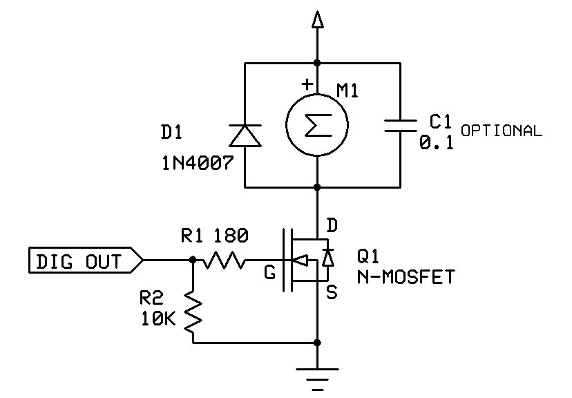

I'm in the process of starting a fan controller project and trying to see if the plan in my head is feasible. Basically what I'm trying to do is wirelessly control a set of fans that can be used to push and pull air. I know that a lot of PC fans can easily be controlled as in/out depending on which lead is powered vs grounded. Before we get into that level of control, what I'm trying to figure out is if it's possible for something like an NodeMCU to be configured to receive wireless control signals from a device like a Raspberry Pi? My Arduino experience is limited to a simple set of code that once flashed to the device basically just runs in a loop, and I'm not too familiar with the signal control aspect. Am I on the right path on this project with the devices I'm looking to use? Or are Arduino's too limited and more suited for loop based projects? Basically this diagram shows the interface process of what I'm looking to achieve.

Here is the updated diagram per the inputs of what was mentioned. Does this help make things a little more clear?
Most all computer fans, nowadays, are brushless motors that can't be reversed (as you found out).
I would recommend using MOSFETs to control the fans instead of relays. Relays need current through the coils, constantly, to be held on. MOSFETs only need a small current when turned on, voltage will hold them in conduction. Relays need transistors anyway so just use the transistor (MOSFET) and eliminate the relay. And you do not need the power supply for the relay coils.
For a brushless motor the diode and cap may not be necessary.

@groundFungus - The only limitations for a MOSFET would be a 3 wire fan correct? So basically, all PWM fans will do? If so I'll change the spec of the fans. As of right now, the fans I have are 2 wire so they are either constant on or off, so that's the only reason I ended up putting a relay into the drawing.

If you use three four pin fans, you do not need the FETs as the speed control pin is a logic level control - I think 5 V. Four three pin fans only include the tachometer connection you do not need but is no impediment.

It was pointed out to me that three pin fans only include the tachometer connection and still require a FET to control them. Essentially, the tachometer is mainly used to warn of cooling failure.
