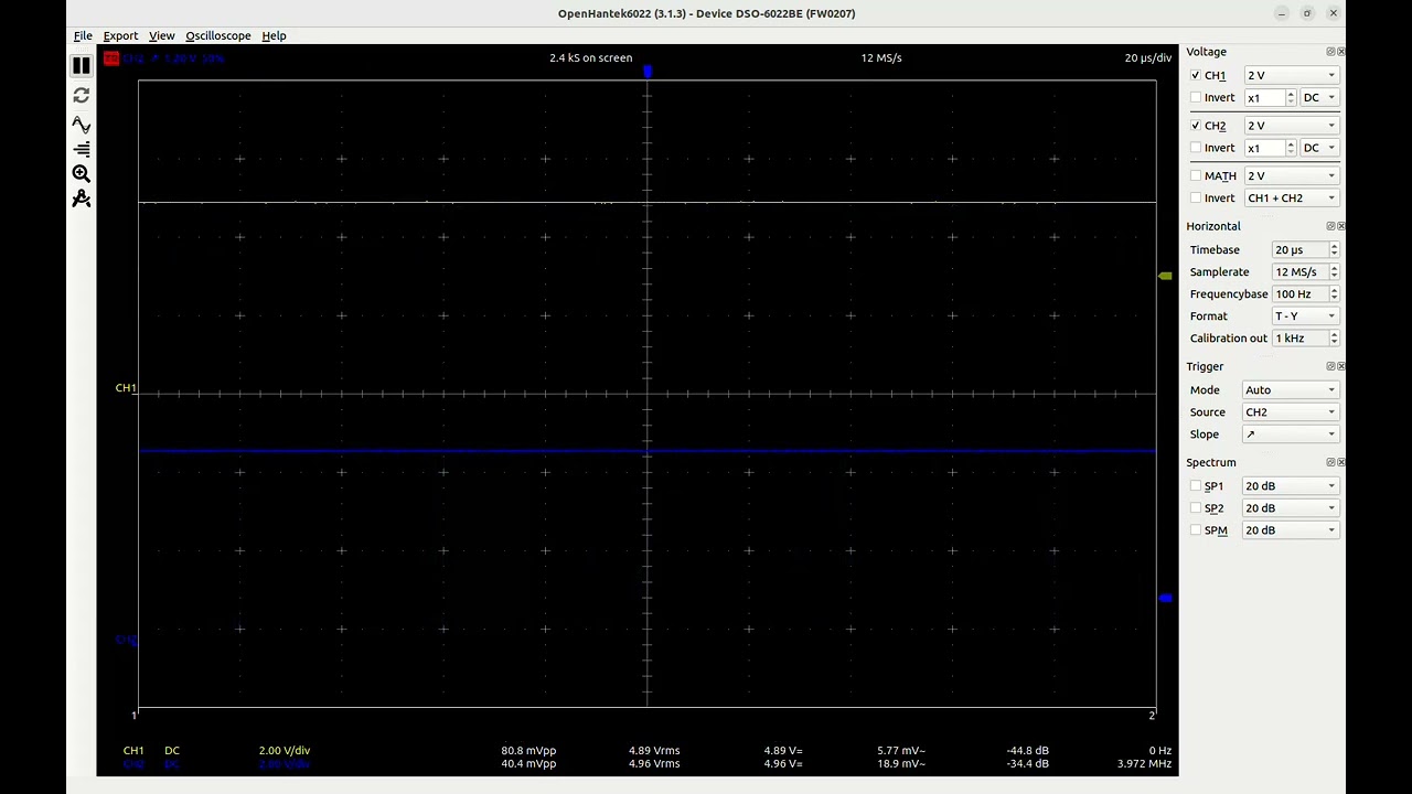

Assuming the library you are using is this one:
I can confirm your code (with @paulpaulson 's suggested change from post #2) produces the expected results.
In the pictures below, CH1 is the voltage at A0 and CH2 is the voltage at pin 9.
(Sorry the quality is so poor! I'm not a YT video expert yet, it seems...)

Exactly. But as you can see from the bottom right corner of the images I posted, the library I used gave an absolutely rock-steady 25.00KHz throughout. I suspect the version you used will be the same.

I verified with an oscilloscope that I am sending 25kHz pulses (40us period) via Pin 9, and that my duty cycle is linearly moving from 0 to 100%, so I am convinced it's a problem with the control board.
