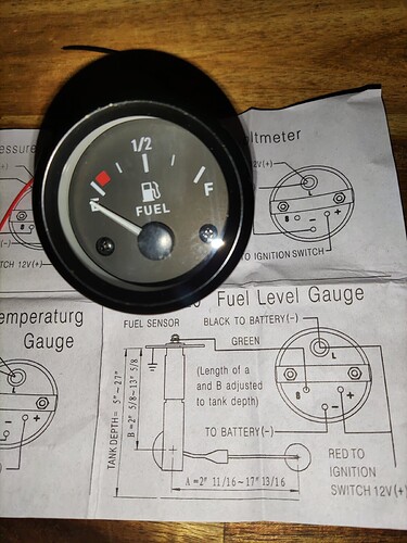

Hi. I'm working on an Arduino Mega based simpit dashboard. I'm using actual vehicle gauges like this:
which on the inside, contains some kind of a motor with 3 terminals, +, - and S (I've been told that this is essentially a voltmeter with a different scale):
I've already managed to create a circuit with a transistor to control the values via PWM, however, the system buzzes at any values other than 0 or 255. I'm pretty sure this is because of the PWM pulse turning on and off rapidly, and I've already read some about fast PWM, but I do have some questions:

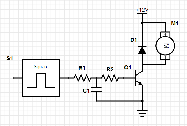

Thank you. So my circuit looks like this:
Where S1 is pin 2 (PWM) in the Arduino Mega.
I'm assuming the RC filter would be adding a resistor and a capacitor, I'm guessing at the collector of the transistor, right? Would the below be the correct diagram? and how do I calculate the R value? and the capacitor?
The time constant of a RC filter is R*C seconds. That's the time when a square wave input raises the output to about 2/3 of the input amplitude.
Placing the filter at the output end will result in low R and high C values. More practical is placing the filter before the transistor base, with handier component values but higher load on the transistor. In either case the transistor is working in the linear area and dissipating more heat than in switching (rectangular) mode.

Looking at your circuits, do you have a series resistor in the the base circuit of Q1 to limit base current?
Thanks.. Tom... :grinning: :+1: :coffee: :australia:
I do, a 1k resistor. I just forgot to put it in the diagram
M1 is a moving coil galvanommetr which responses to slowly varying DC excitation. Therefore, the PWM signal (with Mark/On and Spce/Off) must be somoothed using a LPF (low pass filter) before being asserted on the base of Q1 through a series resitor.
You may try using the following LPF with 1 kHz PWM signal.

Thank you. Though I'm not sure how can I implement that in my circuit. Can you help me out? where would the resistor and capacitor go in my diagram?
I'd split your 1k base resistor in two (2*470) and attach the capacitor between both to GND. You can start with a smaller cap and increase it until the effect is sufficient.
The splited resistor compensates the non-linear characteristic of the transistor BE diode.
I don't have that many components laying around. Do you think 2x510 resistors and a 10 microfarad cap will make it?
This would be the schematics, right?

Ok, I did try it, and unfortunately, looks like the cap is cancelling the PWM effect, so my code, that takes the needle up to 50% for 2 seconds, then to 100% for two more seconds and then to 0% for two more seconds, is only doing the 0 and the 100%.
The meter may have a lower range than actually provided. Find out which duty cycle makes it show less than 100%. Then take half of that value for 50%.
You also can add a series resistor to the meter, of same or higher than the meter resistance.
No, that's not the case, because without the cap, the meter works as expected, but buzzes
Please, post the PWM codes.
It's just analogWrite(2, 0); analogWrite(2, 127); and analogWrite(2, 255);
with delays in between.
What does the meter show at 127?
