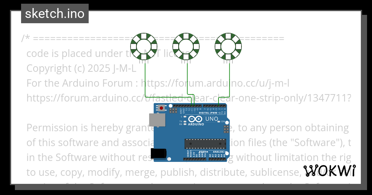

This is highly suspicious. `leds` is an array of `CRGB` and there is no overload for the [] operator for this.
Could you post the full code ?
here is an example on how to use the controllers
> **[FastLedsAndControllers - Wokwi ESP32, STM32, Arduino Simulator](https://wokwi.com/projects/421672952703986689)**
> Run IoT and embedded projects in your browser: ESP32, STM32, Arduino, Pi Pico, and more. No installation required!
you'll see the 3 rings get red first (`fill_solid` + `show` = all the strips are updated)
then I use the specific controllers for each ring to modify the content. First I use `clearLeds` to turn off each ring sequentially with a hard coded 2s pause in between and then I use `fill_solid` to modify the pixel buffer but I don't use show otherwise all the rings would update with that color. Instead I use the controller again and `showLeds` to just update the color of one of the strips, then I change the buffer again and update the other strip.
I think the code is pretty much self explanatory. Of course it would be better to have the pins and controllers in an array rather than in individual pointers. Left as an exercise for you 🙂

> #include <FastLED.h>
> const uint8_t numLeds = 8;
> const uint8_t strip3Pin = 2;
> const uint8_t strip2Pin = 10;
> const uint8_t strip1Pin = 11;
> const uint8_t gBrightness = 128;
> CLEDController* controller1;
> CLEDController* controller2;
> CLEDController* controller3;
> CRGB leds[numLeds];
> void setup() {
> controller1 = &FastLED.addLeds<WS2812, strip1Pin, GRB>(leds, numLeds);
> controller2 = &FastLED.addLeds<WS2812, strip2Pin, GRB>(leds, numLeds);
> controller3 = &FastLED.addLeds<WS2812, strip3Pin, GRB>(leds, numLeds);
> fill_solid(leds, numLeds, CRGB::Red);
> FastLED.show(); // all red
> delay(2000);
> controller1->clearLeds(); // turn off strip 1
> delay(2000);
> controller2->clearLeds();
> delay(2000);
> controller3->clearLeds();
> fill_solid(leds, numLeds, CRGB::Green); // the array is now Green
> delay(2000);
> controller1->showLeds(gBrightness); // updte only strip 1
> fill_solid(leds, numLeds, CRGB::Orange); // the array is now Orange
> delay(2000);
> controller2->showLeds(gBrightness); // updte only strip 2
> fill_solid(leds, numLeds, CRGB::Blue); // the array is now Blue
> delay(2000);
> controller3->showLeds(gBrightness); // updte only strip 3
> void loop() {}
