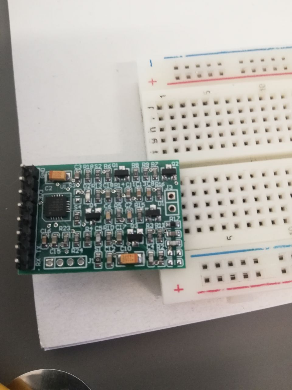

Hello everyone , I bought [this](https://tr.aliexpress.com/item/4001270115038.html?src=google&aff_fcid=d56e47f716834c49bd86186ec446cb37-1632463463545-08434-UneMJZVf&aff_fsk=UneMJZVf&aff_platform=aaf&sk=UneMJZVf&aff_trace_key=d56e47f716834c49bd86186ec446cb37-1632463463545-08434-UneMJZVf&terminal_id=430eda600d8d43ea8b0489cad32b3a1d) from aliexpress. I made a mistake I know ☹ but It is too late. I am trying to built my dogs automatic machine. It is working but my problem is read range. I bought both antenna the round one and the rectangular one. It says we can read from 3-40 cm but when I use the round one, it reads from 5 cm. When I use the rectangular one, it reads from 1 cm. Is there any suggestion for make antenna. I need at least 30-40 cm read range.Wave length = 2235.469m but If I take 132.2 (operational frequency I guess)= 2269.288m L=4.26 mH,R=70 ohm , Q=48 , capacitor= 330pF , Current=50mA BW=2800 Hz .How can I do 30-40 cm reader range antenna?
Here it is only reading from this range.

> [@lentilcapacitor](#):
> BW=2800 Hz .
With such a narrow bandwidth, you must ensure the RFID device and your reader are tuned to an exact same frequency. What test equipment do you have to help with this? Just guessing is not a workable answer.
You can also TUNE the antenna using a variable capacitor if the antenna frequency is too high for the RFID device.
Paul

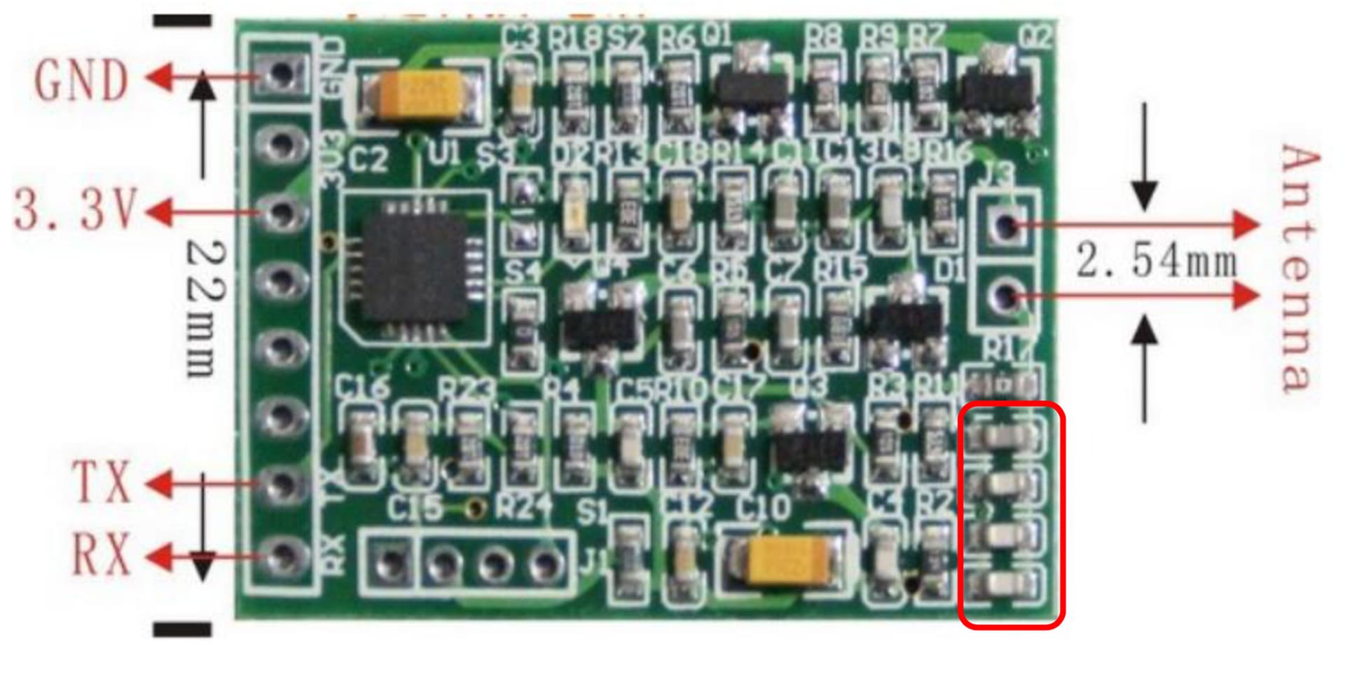

These units usually have "tuning" capacitors... in your case it could be the area highlighted below...
 ![image](https://europe1.discourse-cdn.com/arduino/original/4X/3/0/6/3064ba46dba296c9229a02f67e70700df2cd291a.jpeg)
I have a similar unit and the instructions that came with it are not well written but I believe the idea is that you remove all the capacitors then add back the biggest first... then the next one down in size, until the current being drawn drops... then you skip a capacitor and continue. Not exactly sure where the "working current" is to be measured.
So let's say they are 8,4,2,1 in size for simplicity.
Remove all... current draw 80ma
Add the 8... current draw 90ma ... better
Add the 4... current draw 95 ma ... better
Add the 2... current draw 93ma \< less so gone too far.. remove the 2
Add the 1... current draw 96 ma ... best
So optimal is the 8, 4, & 1 capacitors.

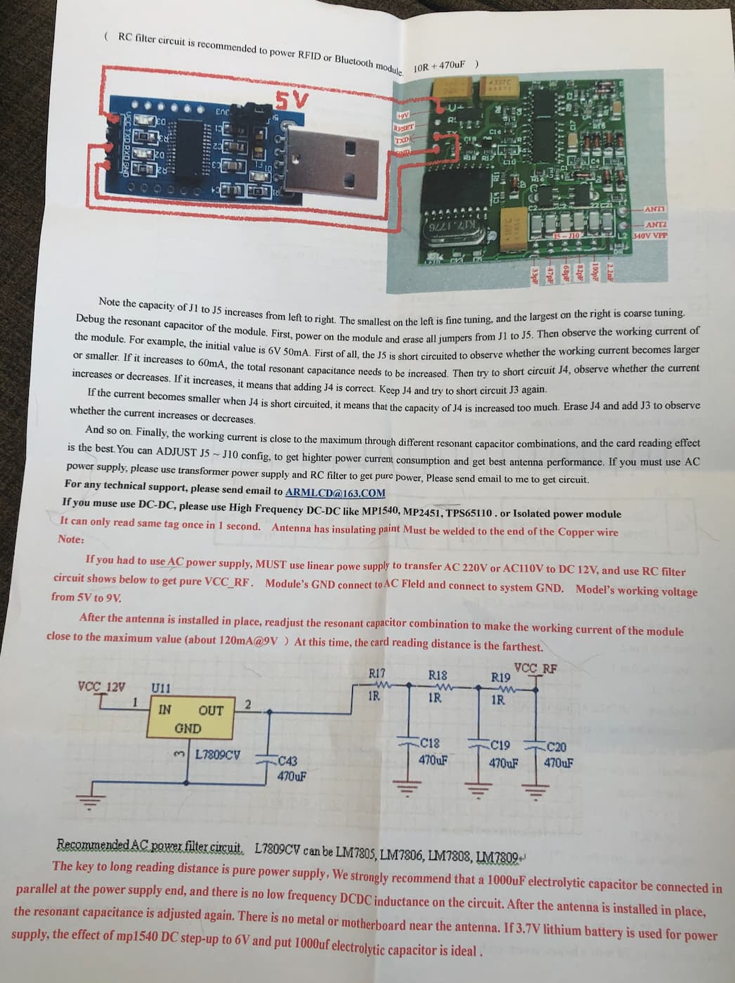

Here are the instructions for my unit... also has some info about stable power supply.
 ![image](https://europe1.discourse-cdn.com/arduino/original/4X/1/9/f/19fd65f4e5a46d58c8017a336759ac57c0ae39c7.jpeg)
Good luck.

I realize I don't have 4 caps.I only have 2caps.
 ![photo6012348959474956118](https://europe1.discourse-cdn.com/arduino/original/4X/5/f/6/5f613dc73d3989c9f0cda0e6459dc11c2170e59d.jpeg)
here is a photo. Since I don't know the caps value, should I desolder 1 caps?
<div class="post-metadata">
**Author:** ![red\_car](https://avatars.discourse-cdn.com/v4/letter/r/b77776/32.png) [@red\_car](https://forum.arduino.cc/u/red_car)\
**Post date:** [October 19, 2021, 7:55am UTC](https://forum.arduino.cc/t/fdx-b-134-2-khz-rfid-reader/912859/16 "2021-10-19T07:55:31Z")
</div>
I'm not really sure.. you could try to follow the same procedure as my instructions but I guess you will not be able to fine tune without the last 2 capacitors.
I guess you could try removing both... see results. Then add back 1 and see if you get a better result, then add back the 2nd. I presume they are different values?

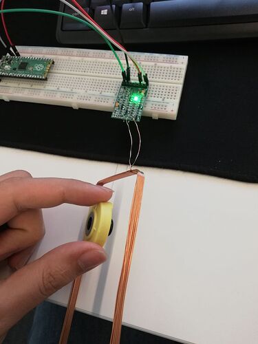

@lentilcapacitor Ok.. so I got the RFID reader working ok. Only problem is I don't have much to test with... it didn't come with any RFID transponders, so my only test subject is this guy...
 ![image](https://europe1.discourse-cdn.com/arduino/original/4X/1/d/2/1d2edec65ae19f9feeb93c3e6742e208306df992.jpeg)
I suspect he has one of the small glass tube versions. I get a reading at about 8 cm. I haven't tried any tuning yet but I will do that next and let you know. I'll also try playing around with different power supplies as that also seems t impact distance quite a lot.
