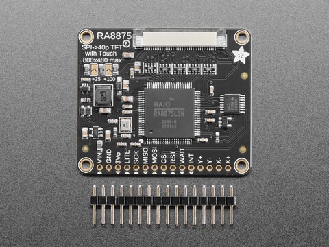

Adafruit has several screens that are designed to work with Arduino's - up to it looks like 7 inches
saildude:
LCDs & Displays, Graphic TFT Products Category on Adafruit Industries
OOOOooo that looks fantastic!! Thank you!!
The 5" and 7" displays from Adafruit won't work with AVR based Arduinos (Uno, Nano, Mega etc.) because they require a special driver module with lots of memory. Not a beginner project.

jremington:
It looks like Adafruit has an adapter board for their 4, 5 or 7 inch screens
