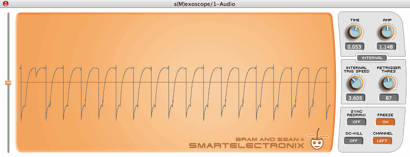

The picture below shows the wave obtained from arduino without any modulation :
and here with the modulation:

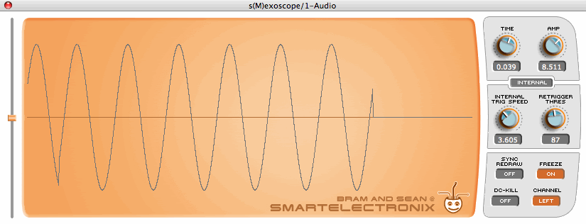

Then I realized that arduino doesn't read the negative voltage and indeed as I feed a sine LFO like this:

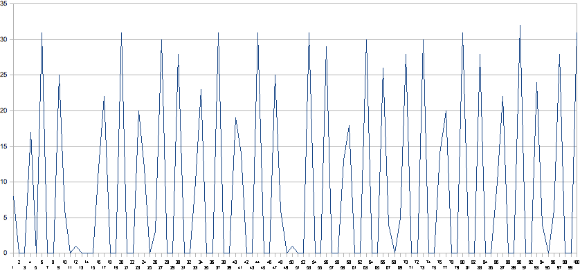

coping the values of the CV_mod variable from the arduino monitor I obtained this:
ok in the last picture, I think that, because of the Nyquist theorem, I didn't obtain a faithful representation of the sine-LFO fed into arduino.
But it also looks like half of the sine wave is missing.
