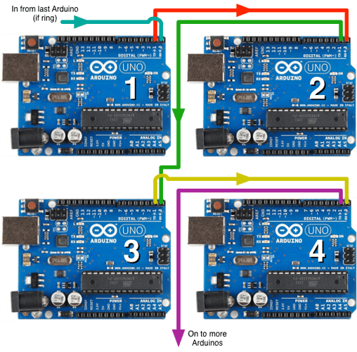

I have many arduinos (let me call them a1, a2, ...an, n = max 40) that have to exchange 2/4 bytes in a "peer-to-peer or master-slaves" wired (or wireless) network. Each arduino should receive bytes from all the others as soon as possible.
The distances a1-a2, a2-a3 ... are about 30 meters...
I2c seems solution, one master loops on all slaves... but i fear that: i2c range extenders like p82b715 are not stable over 20 meters; the loop is too slow;
In a prototipe with five arduinos I'm working on a sort of "parallel" protocol, using digital I/O, but.. more arduinos, more I/O required!
Some suggested solution? Thanks

The serial communication with RX and TX can be cascaded.
But that distances is something for RS-485.
The RS-485 will be reliable, but I don't know if it can be in a star configuration or if it can be casaced.
RS-485 can be used in a star config but at low speeds and it's certainly not recommended.
What I'm doing is a ring network, is that what you mean by "cascaded"?

Thank You very much for Your responses. In attach there is a scheme in which You have to imagine that arduino 1 can ask to arduino k to turn on lamp n-1, arduino 2 can turn on lamp 1 via arduino 1, and so on... time response: not more than 200/300 mS, I think

What I'm doing is a ring network, is that what you mean by "cascaded"?Perhaps I used the wrong term, I think it is called daisy chain.
How-To: Daisy Chain Arduinos via Serial - Make:
uhmmm it sounds good but I think there is the problem to connect the last arduino tx to first rx... too long! For 2-3km I need some serial repeater...
That's true if your string of nodes is in a straight line. But 39 x 30 metres is only 1170m so RS-485 would be OK at slower speeds.
But I forgot to mention that it's a "redundant" ring that is supposed to tolerate broken wires, so if you don't connect the last to the first it's the same as a cut wire and it should work the same.

uhmmm, let's summarize:
(from ardu_n tx) --> rx_ardu_1_tx --> rx_ardu_ 2_tx --> ... --> rx_ardu_n_tx --> (to ardu_1 rx)
in this chain, if ardu(k) have to communicate to ardu(k-1), data must be
echoed through k+1, ... n, 1, 2, k-1 so all wires must be ok! And time of echoing is ..not so short. I think that a i2c data bus is better if... repeaters or range extenders works. Do You agree? :~

In a nutshell I think the following is true
Redundant ring - most robust, slower than a bus because of the store-and-forward of the data
Line (daisy-chain) - pretty robust, slower than a bus
Bus (I2C, RS-485, whatever) - least robust, fastest
Why is a bus less robust? Because any single wire fault kills the entire system. With a redundant ring a single fault has almost no affect on the network. With a line a single fault may or may not have a serious affect, it depends on the physical location of generated data but some of the network will almost certainly keep running.
So no I don't think I2C is more robust, using normal bus extenders like the P82B715 doesn't change anything except the distance you can transmit. The whole system will still die if there's a single line fault
You can use an extender like the PCA9600, this changes the I2C signals into two differential pairs for the trip, but AFAIK this is point to point. IE no longer a bus so (electrically at least) you may as well use RS-485 and async comms. However it does allow you to stick with I2C if you are already comfortable using that.
Now all that is the theory, truth is most networks are buses and they work just fine, however I2C is not designed for these distances and I've not seen any real examples of it being used with these extenders so I can't really comment on their suitability.
