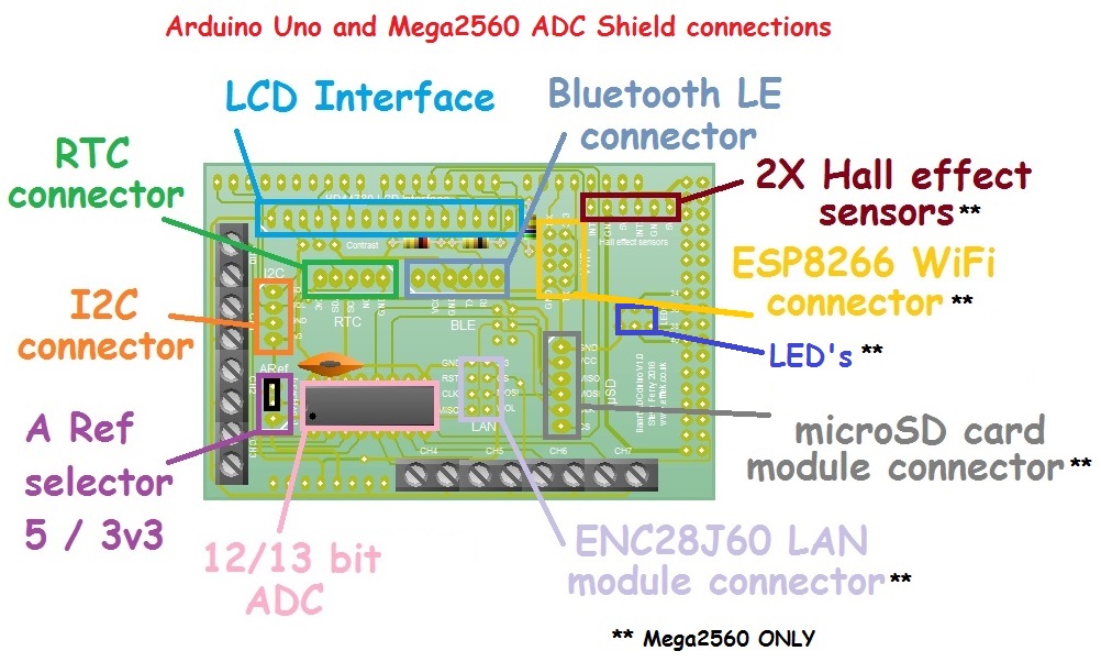

So, I have a project where I have designed an ADC shield which has a 12 bit ADC as well as connectors for Bluetooth, display and rtc. The idea is that the Arduino will sit there talking samples from up to 4 ADXL335 accelerometers, perform an fft, work out the overall acceleration and velocity readings which it will display on a 2004lcd, compare the readings to ISO standards for vibration and tell the user if these readings are healthy, in alert or alarm.
I have it working great on an Arduino MEGA2560 using an FFT library I found here ion the forum, but I'd like to change to a DUE and make use of the extra processing power and bigger fft sizes.

What is the board, why you are using mcp3208?
Well, the reason I'm using MCP3208 is because I designed an ADC shield for the Mega2560 as 10 bits is not enough for my project. The board also has lots of other connections, RTC, Bluetooth and HD44780 LCD module being the most important ones to me.
The aim of the project is to attach several accelerometers to a machine - eg motor nde bearing, motor de bearing etc. The unit loops round checking the vibration levels by taking a sample, doing and fft and calculating overall levels in both velocity and acceleration. It then compares these levels to ISO standards and displays the levels and the machine condition on the lcd. If the condition is other than healthy, the user can download a twf via Bluetooth and email it to me for in depth analysis. Take a look at www.efftek-uk.com That's me, that's what I do!
So that's what the board is and why mcp3208. Now, I know that the due has 12 bit sampling, but the board was initially designed for the Mega which doesn't. See photos attached.
Steve.
